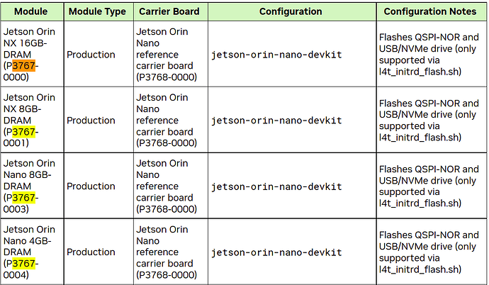

  1. $ cat /etc/nv_boot_control.conf
  2. /etc/nvpmodel.conf
  1. cat /etc/nv_boot_control.conf
TNSPEC 3767-300-0003-M.2-1-1-p3509-a02+p3767-0000-
COMPATIBLE_SPEC 3767–0003–1–p3509-a02+p3767-0000-

It seems you are using Orin NX 8GB (Model: P3767, SKU: 0003)
OC2 is 15W, OC3 is 20W

(Model: P3767, SKU: 0003) should be ORIN NANO 8GB:
Is it possible to apply your new power mode to NANO 8GB module?
Sorry that it was my typo, you are using Orin Nano 8GB module.
Yes, please update and apply that nvpmodel configuration on your board.
