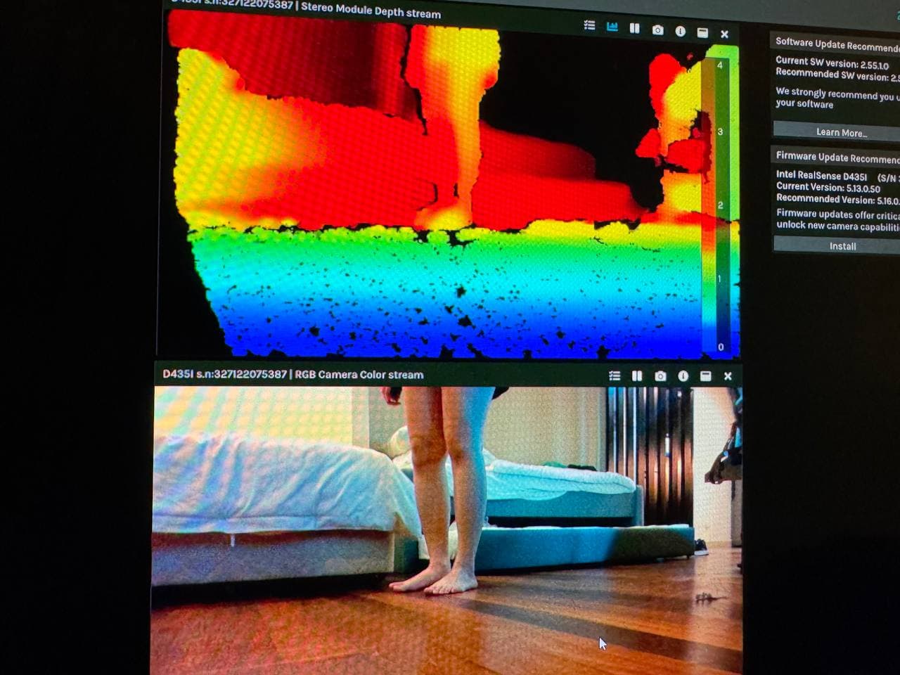

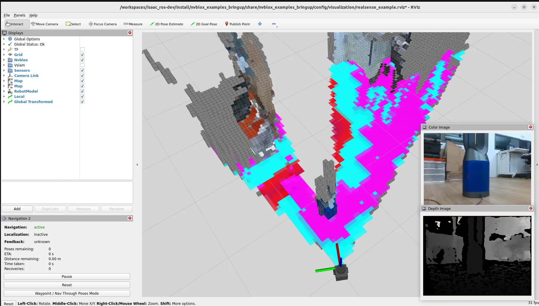

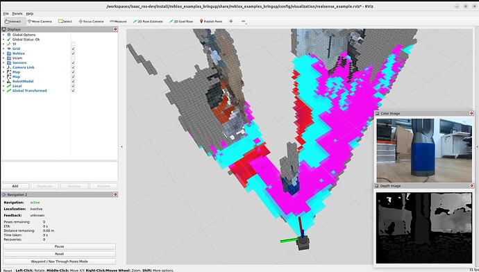

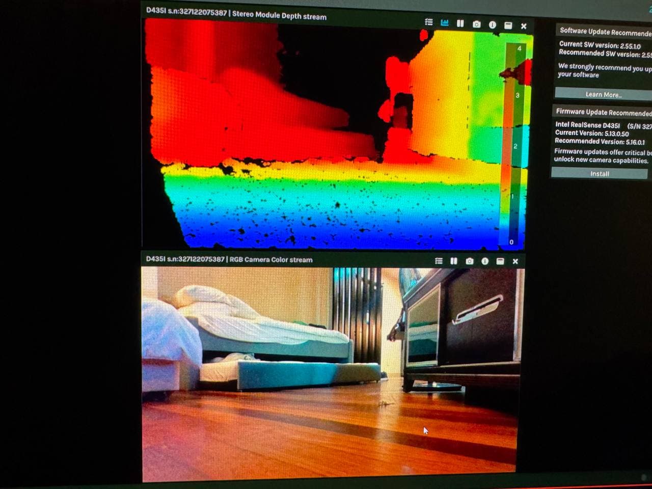

I’m currently facing accuracy issues with the global costmap (visualized in red, blue, and pink) generated by the NVBlox stack in the Isaac ROS pipeline. As shown in the attached image, the costmap does not correctly reflect the actual environment. Even when the floor is completely clear of obstacles, the global costmap continues to indicate false positives.
I suspect the issue might be due to unreliable depth sensing from the Intel RealSense D435i. Despite tuning efforts, the depth data still appears inaccurate. The RealSense is currently running firmware version 5.13.0.50. If anyone has recommendations for improving depth reliability or costmap fidelity in this configuration, I’d appreciate any suggestions.

Questions / Clarification:
  • Are there any recommended filters or preprocessing steps for RealSense depth data to improve mapping accuracy with NVBlox? Or this is some other issue?
  • Is the use of odom as the global frame advisable in this configuration, or should I switch to map?
  • Do I need to fine-tune the max_obstacle_distance, inflation_distance, or camera mounting TF more precisely?

Hi @m230060
Thank you for your messages.
Examining the posted images, it appears that the ground is infiltrating the costmap.
Try to tune the esdf_slice_min_height (and depending on robot height, the esdf_slice_max_height ) parameter following the documentation ROS Parameters — isaac_ros_docs documentation.
The slice bounds can be visualized with the ~/map_slice_bounds topic ROS Topics and Services — isaac_ros_docs documentation.
Everything between the two visualized planes will be included as an obstacle in the costmap.
The min/lower plane should be above the ground (but low enough to include low lying objects that need to be detected as obstacles).
Best,
