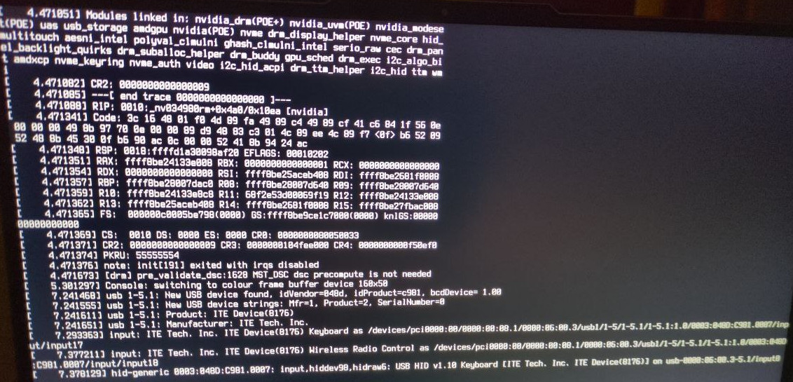

No HDMI output on Nobara Linux 42, from Lenovo Legion 7i w/ RTX 3080
Hello, I’m running Nobara’s KDE Plasma Desktop Edition on my 2021 Lenovo Legion 7i, with the RTX 3080, and nVidia driver version 580.95.05 (closed) (also tried with latest open version). When attaching an HDMI 2.1 cable to my LG C9 OLED (2019), the TV recognizes a device has been added, but after a few seconds says “no signal”.
The laptop screen immediately goes black and I’m unable to return it, whether I disconnect the cable, use Win + P (before or after disconnecting), or even Ctrl + Alt + F4 (before or after). The only way I’m able to return to my laptop screen is via a hard reset. I’m doing all of this in discrete GPU mode only.
Here’s what I’m finding in the logs after rebooting:
Oct 15 00:24:25 CRAZYHORSE kernel: NVRM: GPU at PCI:0000:01:00: GPU-d755d0b6-e03a-ce6f-40cf-0603c6e1fcfc Oct 15 00:24:25 CRAZYHORSE kernel: NVRM: Xid (PCI:0000:01:00): 120, pid=3638, name=kwin_wayland, GSP task exception: load access page fault (cause:0xd) @ pc:0x12b017c, partition:2#0, task:3 Oct 15 00:24:25 CRAZYHORSE kernel: NVRM: Reported by libos partition:2#4 kernel v3.1 [0] @ ts:1760480665 Oct 15 00:24:25 CRAZYHORSE kernel: NVRM: RISC-V CSR State:
… it went kaput:
Oct 15 00:24:25 CRAZYHORSE kernel: nvidia-modeset: ERROR: GPU:0: Failure reading DP dongle info for display device LG Electronics LG TV (HDMI-0). Oct 15 00:24:25 CRAZYHORSE kernel: nvidia-modeset: ERROR: GPU:0: Failed to query VR headset for LG Electronics LG TV (HDMI-0) Oct 15 00:24:25 CRAZYHORSE kernel: nvidia-modeset: WARNING: GPU:0: Failure processing EDID for display device BOE Technology Group Co., Ltd (DP-4). Oct 15 00:24:25 CRAZYHORSE kernel: nvidia-modeset: WARNING: GPU:0: Unable to read EDID for display device BOE Technology Group Co., Ltd (DP-4)
Can anyone tell me if they’ve experienced this before please, and is there anything else I can try to make this work?
Many thanks in advance,
Philip

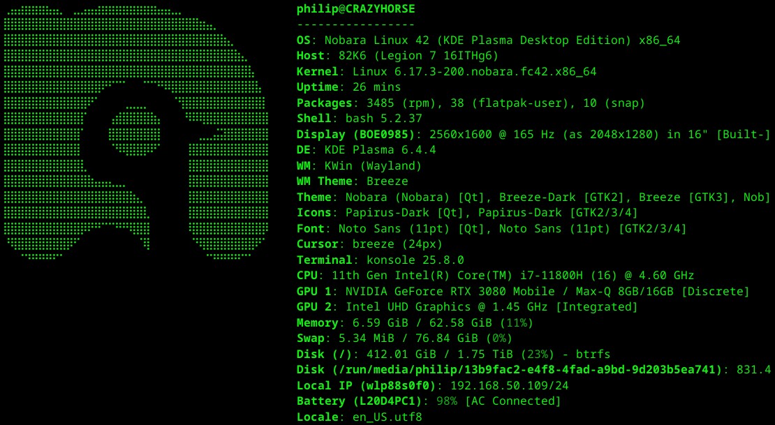

Here as well are the details of my laptop that’s experiencing this issue:
Worth mentioning also is that I’ve since tested this with my older (2016) Alienware 13” R3, with is also running the same distro as above (Nobara 42 Plasma), running a 6th gen Intel i7 and a GTX 1060 (using the latest closed drivers), and the HDMI connection to my TV works perfectly.
Since my Legion i7 laptop experiences this issue on both the latest closed and open drivers, I’m really not sure why this is happening. Thank you sincerely for all of your help! I really, REALLY, want this to work and I absolutely love this distro and environment. If you could please fix this issue you’ll keep an nVidia fan for life!!
Please let me know if there’s anything else you’d like me to try on my side?
Cheers and kind regards,
Philip

we face the same exact crash in the firmware. can u guys at least pretend you’re caring and post a “we’re tracking this as issue 25908250908279085729857”
edit: stack trace also identically matching Lenovo Legion laptop + NVIDIA drivers 580.95.05 = tv screen freezes the system - Kernel, boot, graphics & hardware - EndeavourOS
Thanks for that final link you provided - I forgot to mention that (as described therein) I also have the same freezing issue when attempting to boot with the HDMI cable already plugged-in, and I also have to ask: why is it detecting my HDMI as a DP (DisplayPort)?
Again, thank you @vanditd and team for your kind assistance in this matter! ☺️

Issue different on kernel 6.17.4-201
Closed 580.95 drivers no longer causes crash upon connected external monitor
Open 580.95 drivers no longer causes crash upon connected external monitor
Both drivers still don’t output to external display.
Downgrading open drivers by running sudo dnf remove kmod-nvidia-6.17.4-201.nobara.fc42.x86_64-3:580.95.05-1.fc42.x86_64 and then running sudo dnf downgrade nvidia* akmod-nvidia --exclude=nvidia-gpu-firmwar from 580.95.05 to 580.82.09 still fixes the issue.
At least this confirms that downgrading on either open or closed fixes the issue.
