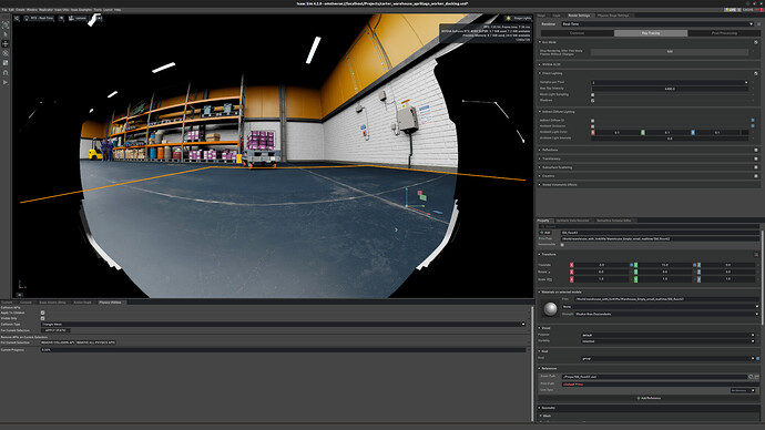

Hello, I’ve been exploring the world of Isaac ROS with IsaacSim! While following the tutorials on docking with nova carter in IsaacSim (using apriltag and foundationpose), I found that it is not working as intended.
When I send the mission command, the robot usually stops and makes a turn. I followed the IsaacSim setup instructions, including docking station placement and lidar configuration, and I had no problem running each of the DNN models (ess, rt-detr, foundationpose).
The error message I get is like this:
[controller_server-7] [ERROR] [1748604326.447607331] [tf_help]: Transform data too old when converting from odom to map
[controller_server-7] [ERROR] [1748604326.447683169] [tf_help]: Data time: 5s 66666930ns, Transform time: 4s 850031451ns
[controller_server-7] [WARN] [1748604326.447878909] [controller_server]: Unable to transform robot pose into global plan's frame
Using the ros2 run tf2_ros tf2_echo map odom command, I found that the transformed data being sent lags behind the sim time, which prevents the robot from operating properly.
My system setup is as follows:
  • IsaacSim on node A: x86_64 (13th Gen Intel(R) Core™ i7-13700K) with RTX 4080 super
  • isaac ros on node B: Jetson AGX Orin 64GB
  • Both nodes directly connected with 1Gbps Ethernet, using CyclonDDS for RMW
I’m suspecting the network, because when I run both IsaacSim and Isaac ROS on the same node (with an RTX 3090 for sufficient GPU memory), the transformed data is produced in a timely manner and the docking succeeds. Also, it is not an issue with the JAO, since I was able to reproduce the same problem with another x86_64 machine equipped with an RTX 3090.
Could you please provide any hints on the casuse of this problem?

Hi @jjong0025 welcome to the community.
Please try with Isaac Sim 4.5 as this is the latest stable version.
Based on your description, it sounds like network lagging issue. As a workaround, you can set the transform tolerance timeout to a larger value so it is able to do the transformation (code).
Did you set up a unique ROS_DOMAIN_ID? This can help prevent potential disruption from other ROS applications.

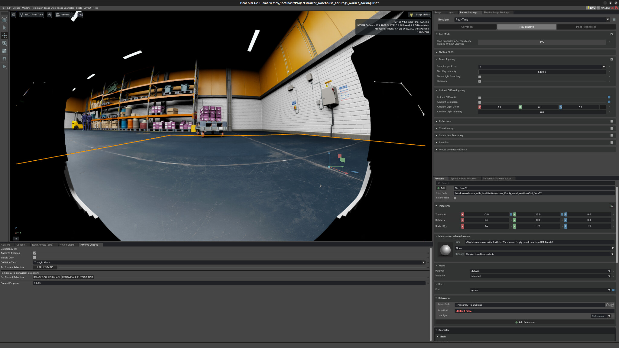

Thank you for your reply, zhengwang.
To clarify, I am using a random ROS_DOMAIN_ID (100) for both Isaac ROS and Isaac Sim.
Before moving on to Isaac Sim 4.2, I tried adjusting the transform tolerance timeout (controller_server:ros__parameters:FollowPath:transform_tolerance) from 0.2 to 3.0, located at /opt/ros/humble/share/isaac_ros_vda5050_nav2_client_bringup/config/carter_navigation_params.yaml.
This did work, since the time difference between the transformed data was about 2.5 seconds in sim time, as shown in the first video (top-left terminal). However, it still wasn’t enough for the robot to complete its mission due to the inherent time delay.
The video above shows the case where both Isaac ROS and Isaac Sim are running on the same node. The time difference is about 0.4 seconds in sim time, which is approximately 6.25x faster than in the problematic case.
I also measured the topic hz for /tf in various configurations. Based on the results, I concluded that the problem is due to the reduced data frequency for /tf and /chassis/odom as the following results suggest (the topic hz for /chassis/odom showed similar results, thus omitted).
Running Isaac Sim only on x86_64
Measured on x86_64 (local)

And following this, I disabled some ray tracing features, including Indirect Diffuse Lightning (Indirect Diffuse GI & Ambient Occlusion), Reflections, and Translucency.
Rendering features on
Rendering features off
Now I get the following RTF values:
(1) IsaacSim only
root@ubuntu:/workspaces/isaac_ros-dev# ros2 topic echo /topic
data: 0.27231866121292114
data: 0.24805614352226257
data: 0.2501446306705475
data: 0.2568632960319519
data: 0.26747265458106995
data: 0.24819239974021912
data: 0.44534045457839966
data: 0.26197099685668945
data: 0.2611120939254761
data: 0.427651047706604
(2) Isaac ROS running
data: 0.14299245178699493
data: 0.07791684567928314
data: 0.12510919570922852
data: 0.13395315408706665
data: 0.14946362376213074
data: 0.1467985212802887
data: 0.0980483666062355
data: 0.13959549367427826
data: 0.14837419986724854
data: 0.1428917497396469
It improved the simulation speed (though only when running IsaacSim), and the time difference between the transformed data—verified using the ros2 run tf2_ros tf2_echo map odom command—was reduced from 2.5s to 0.2s (in sim time).
However, I am still concerned about the relatively low RTF value when running Isaac ROS. This value remains the same even when turning off the direct light.
