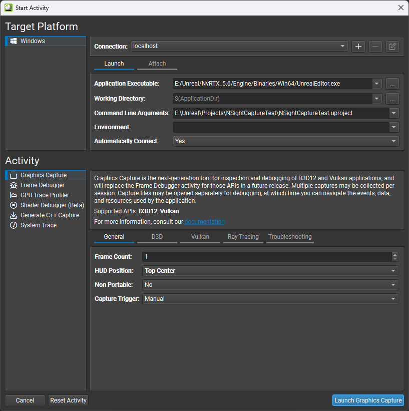

The repro steps are as follows:
  1. Create a new project using NvRTX5.6 UnrealEditor
  2. Start NSight Graphics as administrator.
  3. Launch and automatically attach an UnrealEditor process

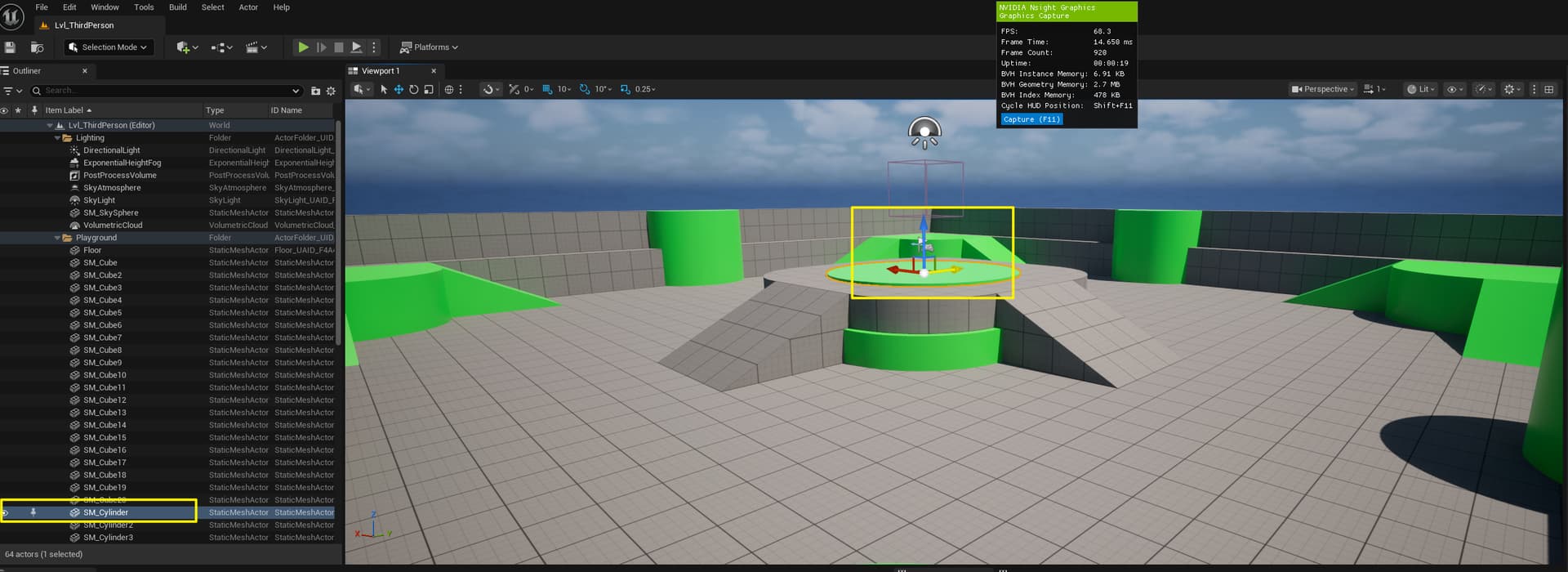

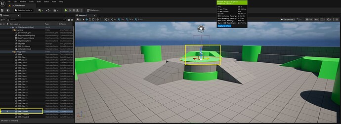

  4. Pick an item in the default level
  5. Crash happens after clicking the Capture button.

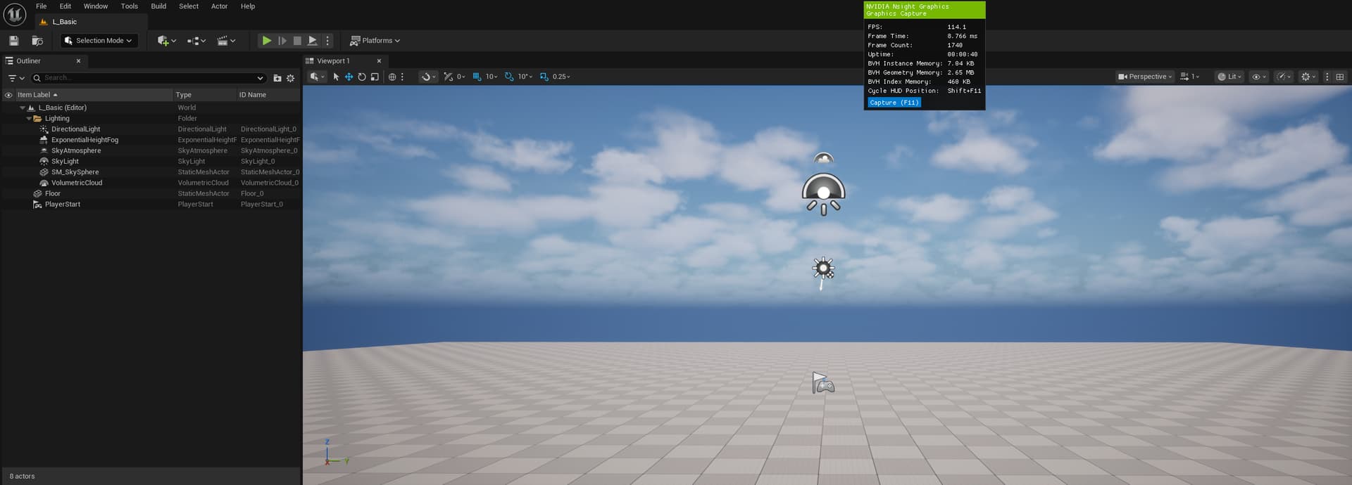

  6. Or create and save a new basic level.
  7. It also crashes when capturing
