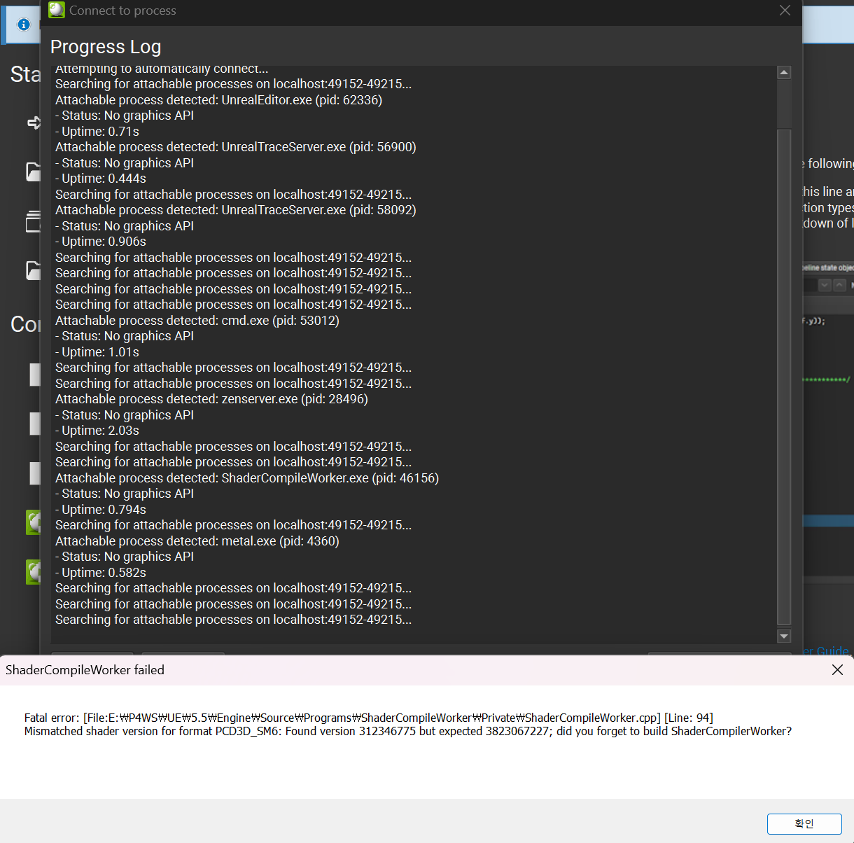

NSight Graphics crashes on startup. (it’s a standalone app)
As soon as I run NSight Graphics, it crashes immediately.
This issue occurs in both versions 2025.1 and 2025.2.
Version 2023.4.1 runs, but while the Unreal Engine launch parameter -dxd11 works, -dxd12 does not.
please help…
The crash screen is shown below. (versions 2025.1 and 2025.2)
You can download dump file below. (versions 2025.1)

Are there any special to your Unreal Engine sample? We did some tests on the UE public samples before release. On the other hand, could you please provide your detail steps to reproduce the crash?

Simply run NSight 2025.1 and 2025.2 it crashes after splash image.
Where can I get log files? I couldn’t find them.
When I run NSight 2023.4.1, the failure reproduction steps are as follows.
Preparing to launch...
Launched process: UnrealEditor.exe (pid: 61536)
E:/P4WS/UE/5.5/Engine/Binaries/Win64/UnrealEditor.exe E:\P4WS\Trunk\Client\ProjectTT.uproject
Attempting to automatically connect...
Searching for attachable processes on localhost:49152-49215...
Attachable process detected: UnrealEditor.exe
- Status: No graphics API
- Uptime: 0.769s
Attachable process detected: UnrealTraceServer.exe
- Uptime: 0.895s
- Uptime: 0.547s
Attachable process detected: cmd.exe
- Uptime: 0.934s
Attachable process detected: zenserver.exe
- Uptime: 1.39s
Attachable process detected: ShaderCompileWorker.exe
- Uptime: 1.06s
Attachable process detected: metal.exe
- Uptime: 0.503s
- Uptime: 0.546s
Launch process exited. Searching for attachable child processes...
Failed to connect. The target process may have exited.
I tried rebuilding ShaderCompilerWorker as mentioned in the error dialog, but the result was the same
Thanks~

That’s weird. I am not sure what caused this, could you delete this folder and give it another try? Remove all files in %APPData%\NVIDIA Corporation (Please backup these files at first), and run Nsight Graphics again.
I can run the official UE5.5 editor (downloaded from EPIC launcher) with default FPS template uproject on Nsight 2025.1 and 2025.2 smoothly. Could you take a try on the public build of UE?

After deleting the specified folder, the issue has been completely resolved.
