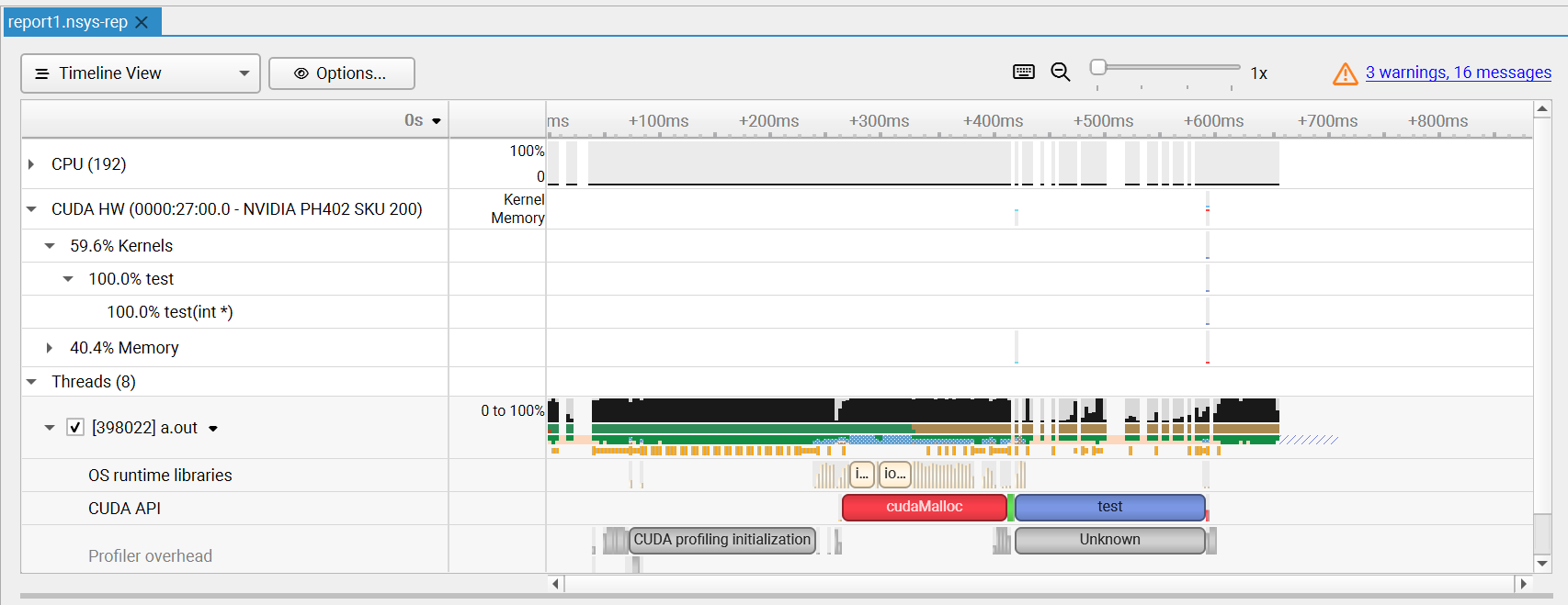

I am profiling a CUDA program on WSL using nsys, but the profiling file seems to have no trace of CUDA kernel calls. An example is provided below:
I firstly write a simple cuda program, test.cu:
#include <iostream>
__global__ void test(int* a){
	int idx = blockIdx.x * blockDim.x + threadIdx.x;
	++a[idx];
int main(){
	int* arr;
	cudaMalloc(&arr, sizeof(arr[0]) * 10);
	cudaMemset(arr, 0, sizeof(arr[0]) * 10);
	test<<<10,1>>>(arr);
	int arr_res[10];
	cudaMemcpy(arr_res, arr, sizeof(arr[0]) * 10, cudaMemcpyDeviceToHost);
	for(int i=0; i<10; ++i){
		if(arr_res[i] != 1) std::cout << i << ':' << arr_res[i] << std::endl;
	return 0;
then I compile and profile it in my WSL using nvcc test.cu -o test && nsys profile ./test, and opened the generated report1.nsys-rep in Nsight System in Windows:

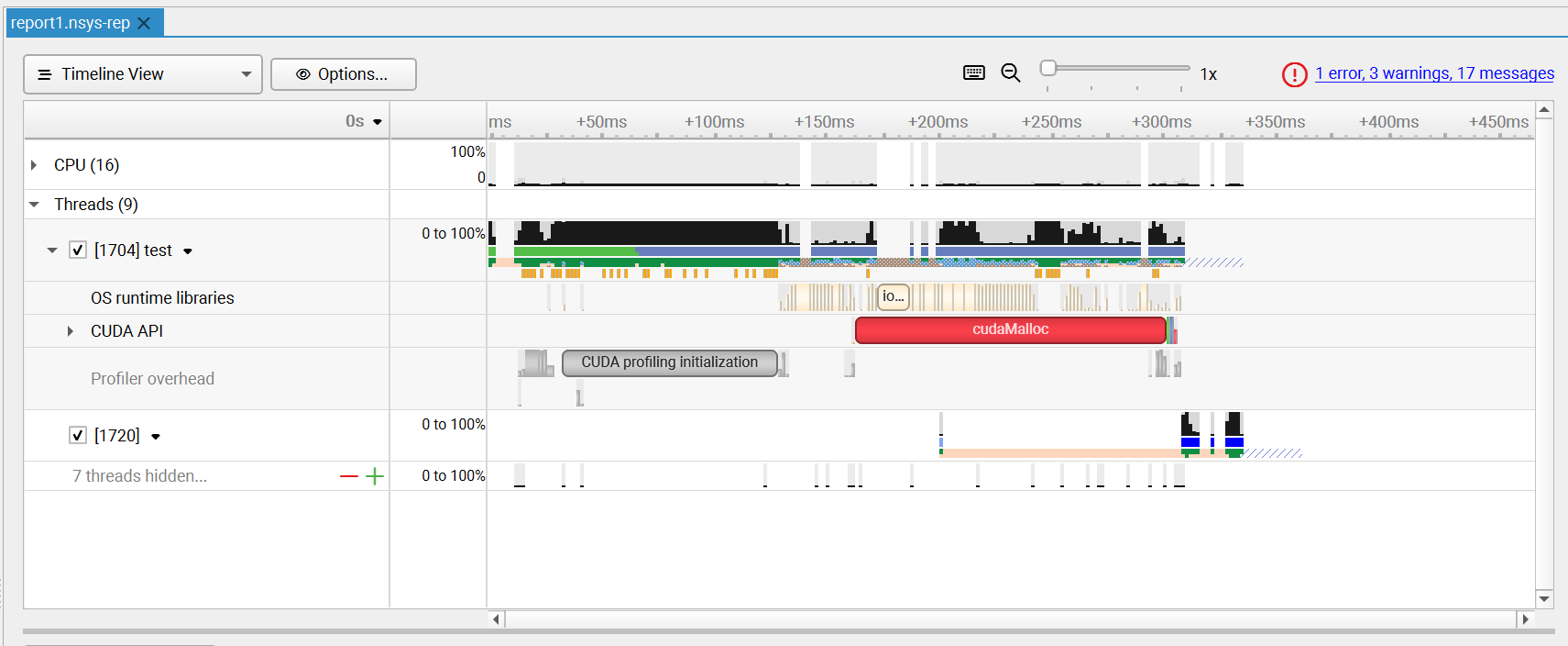

It does not show the GPU (kernel calls) and warns me that there is an error:
However, I reproduced the whole procedure on another linux server, and it does trace kernel executions and shows no error at all:
So how can I get kernel execution traces in WSL?

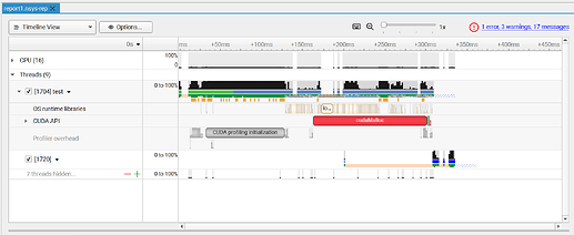

I’ve found out that the solution in the post below is useful:
https://forums.developer.nvidia.com/t/nsys-doesnt-show-cuda-kernel-and-memory-data/315536
The problem is solved by now (although the error still exists, which doesn’t affect me in my context)
