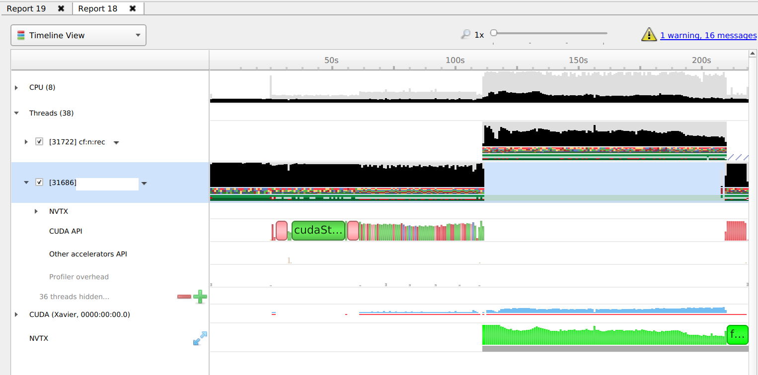

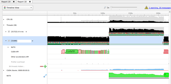

When we compile our project to run a segmentation network on GPU all of our profiling frames show up in nsight systems remote profiler. But when we compile it to run the net on the DLA, not only do the NVTX frames stop showing up, it seems all of the GPU data and much of the CUDA traces are lost as well.
The whole point of moving our segmentation to the dla was to see if we could reduce the load on the GPU but we can’t actually measure that. Is there any way to get nsight systems to work correctly here?

The other thing I forgot to mention is that when I run the program under nvprof, all of the ranges are observed as expected. It’s only when I run nsight systems remotely that things don’t work right.

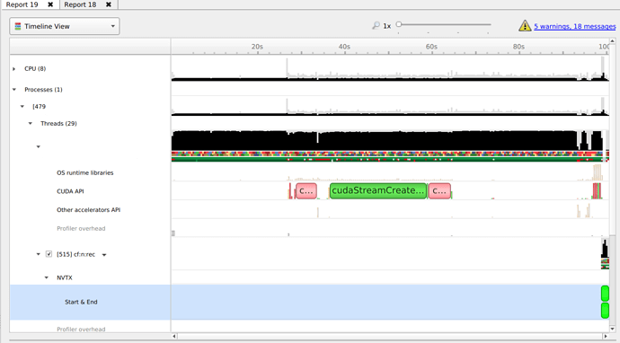

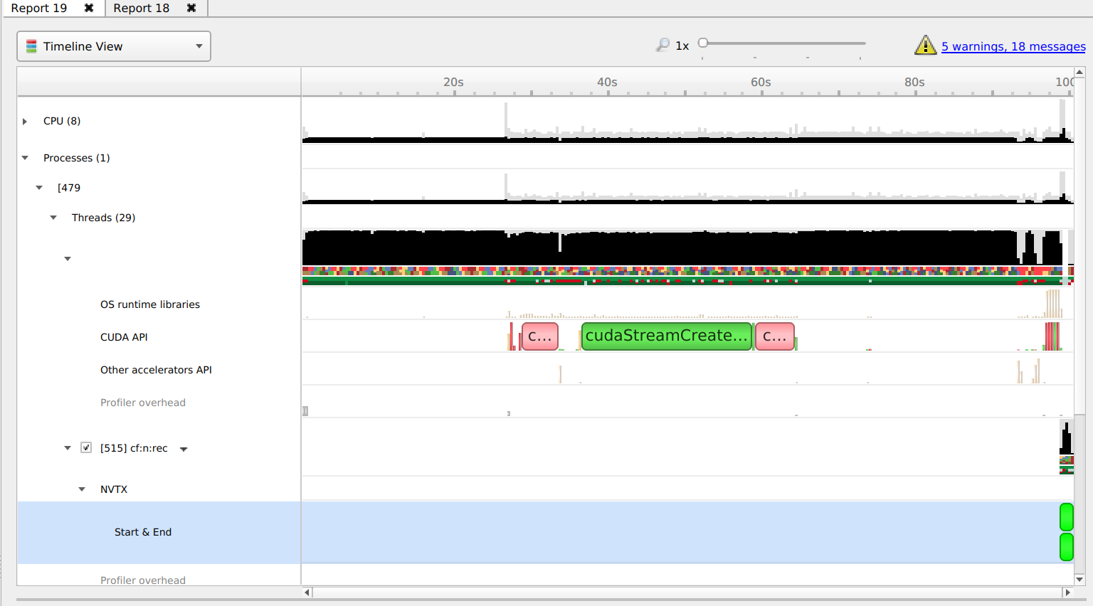

The reports have a completely different structure. When running on GPU it has CPU, Threads, CUDA, and NVTX at the top level. When running on DLA it has CPU, Processes, and iGPU at the toplevel. NVTX only shows up under the Process->process name.
And when running on the DLA the diagnostics summary has warnings about “Not all NVTX/CUDA events might have been collected” that don’t appear when running on GPU.
Actually, looking again, it seems the run on DLA stops after 100s whereas the GPU version stops at 200s. It like the profiler stops gathering events as soon as the DLA starts running? Or maybe running it under the profiler is causing the process to abort early?
