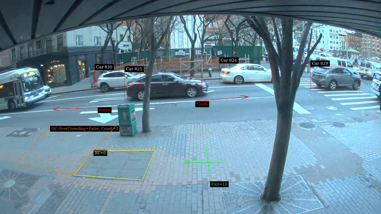

When I run the deepstream-nvdsanalytics-test sample app I notice that on detected vehicles a direction gets added to the bounding box overlay. For example it says “Vehicle 123131234 DIR: North” or if the vehicle stops it says “Vehicle 123131234 STOPPED”. If I try to recreate that same setup with the deepstream-app the “DIR: North/South” or STOPPED text does not get added to the overlay. How do I enable that?
STOPPED
DIR:North
deepstream-app
No DIR: or STOPPED

I was expecting the deepstream-nvdsanalytics-test app, the gst-launch pipeline and the deepstream-app to give the same visual results with the same configuration but deepstream-app seems to give a different result. I would love to know why it’s doing that and how to make it output the same overlay info as the other two methods.

For simplicity’s purpose, the deepstream-app displays lesser overlay info about the detected objects i.e. the application-specific metadata is removed from obj->text_params.display_text parameter which contains the text to be displayed.
So if you want to access the info such as the direction you have to make changes accordingly in obj->text_params.display_text parameter present in process_meta() of deepstream_app.c file
or you can disable process_meta () if you want to display as expected in the nvdsanalytics test app or pipeline.
