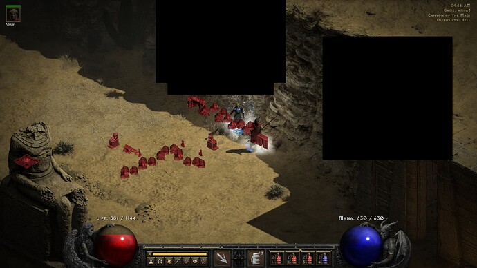

NVIDIA 495.44 regression graphical glitches in diablo 2 resurrected
So yeah i have started recieving graphical issues with 495.44 and reverting back to 470.74 solves it.
on an Nitro AN515-45 with ryzen 5800h and NVIDIA GeForce RTX 3060.
uploading screenshot of it happening and nvidia-bugreport

Regarding your original issue, I suppose the 495.44 is a beta release and has weird issues.

I am experiencing the same issue today after upgrading from 470. I am running an RTX 3080 Ti.
the exact same blocky graphics in diablo II resurrected. Nvidia 515.57 with vulkan-sdk-1.2.176 on slackware 15 64bit
multilib. Linux kernel 5.15.38. Any questions about logs
please let me know maybe i can help.
515.57 i just confirmed upon downgrading to 470.74 from nvidia 515.57 the blocky graphics artifacts
are gone. I guess newer isn’t always better at least in this case.
