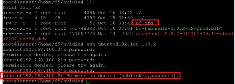

But after BF-Bundle Installation, I have Console/SSH Login Password Issue, it always says that my password is wrong.
Here is the methods I have tried.
  1. I chose the option 2 to set Pre-defined Password(lanner or lanner123) when installing BF-Bundle image.
After installation, the Host can connect to BF3 via BF3 console or SSH
But both SSH BF3 console can’t login because it shows password error
  1. I also try to choose the option 1 to set No Pre-defined Password, but it still need password for SSH or Console Login
  2. I tried these 3 default password for console login, but useless
ubuntu, nvidia, bluefield
  1. I re-install DOCA Host and BF-Bundle for these 2 versions, repeat step 1-3, all of them have login password issue.

Dear Tuanama00,
I have tried your method more than 10 times just like I said before, but it didn’t work. It always shows password error when console or SSH login.
Here is what I have done again and again.
  1. I re-installed both DOCA 2.9.2 LTS (bf-fwbundle-2.9.2-32-prod.bfb) and DOCA 3.1.0 (bf-fwbundle-3.1.0-76_25.07-prod.bfb) following the official DOCA Host and BF-Bundle installation guides.
  2. After each installation, the DPU boots correctly and is reachable from the host via RShim, but both SSH and console reject all passwords.
  3. The console immediately prompts for a password and returns “login incorrect”, so it is impossible to reach a shell to change the password manually.
  4. I tested both installer options:
    • Option 1: “No Pre-defined Password” → still requires a password.
    • Option 2: “Pre-defined Password (lanner / lanner123)” → same failure.
  5. Default credentials (ubuntu/ubuntu, ubuntu/nvidia, ubuntu/bluefield) also fail on every attempt.
  6. This behavior occurs consistently across both DOCA 2.9.2 and 3.1.0 releases.
  7. Based on my analysis, the issue appears related to cloud-init automatically locking or overwriting the default “ubuntu” account during first boot when using RShim installation.
  8. Request: Could NVIDIA engineering confirm if this is an expected behavior in recent releases, and provide the official method or installation flag (e.g., --no-autoinstall or --disable-cloud-init) to prevent cloud-init from locking the default account during BF-Bundle installation?
  • BFB installation log → the password is ‘ubuntu’ in this case

Dear Tuanama00,
I have already mentioned that at the first begining, I have tried both
option 1: No Pre-defined Password
option 2: Pre-defined Password
SSH or Console login always have password error and can’t login to BF3 successfully.
Please read my whole story that I have tried and give me some useful information.

I just find that image I downloaded is the “bf-fwbundle-2.9.2-32-prod.bfb” which doesn’t contain OS image inside.
After I downloaded “bf-bundle-2.9.2-31_25.02_ubuntu-22.04_prod.bfb”. The password can be changed, and I can login to BF3 now.
Case can be closed now.
