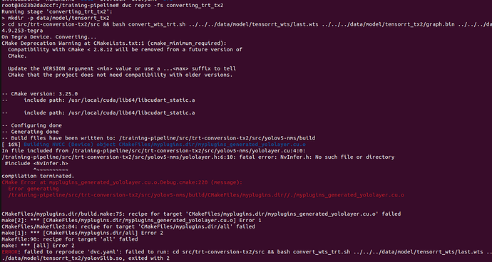

I am using l4t-base:r32.6.1 to build a docker image. The image should mount all the necessary files from CUDA, tensorrt from host machine to the docker image. But it failed to mount which causing building error for my codes.
I can find the NvInfer.h in my host machine:
run sudo find / -name NvInfer.h:
/usr/include/aarch64-linux-gnu/NvInfer.h
run find / -name NvInfer.h in the docker image, it showed nothing.

Based on the information in this page, libnvidia-container/mount_plugins.md at jetson · NVIDIA/libnvidia-container · GitHub, it should be able to mount all the necessary files from host to docker image, but it still failed.
Could anyone know how to solve this problem?

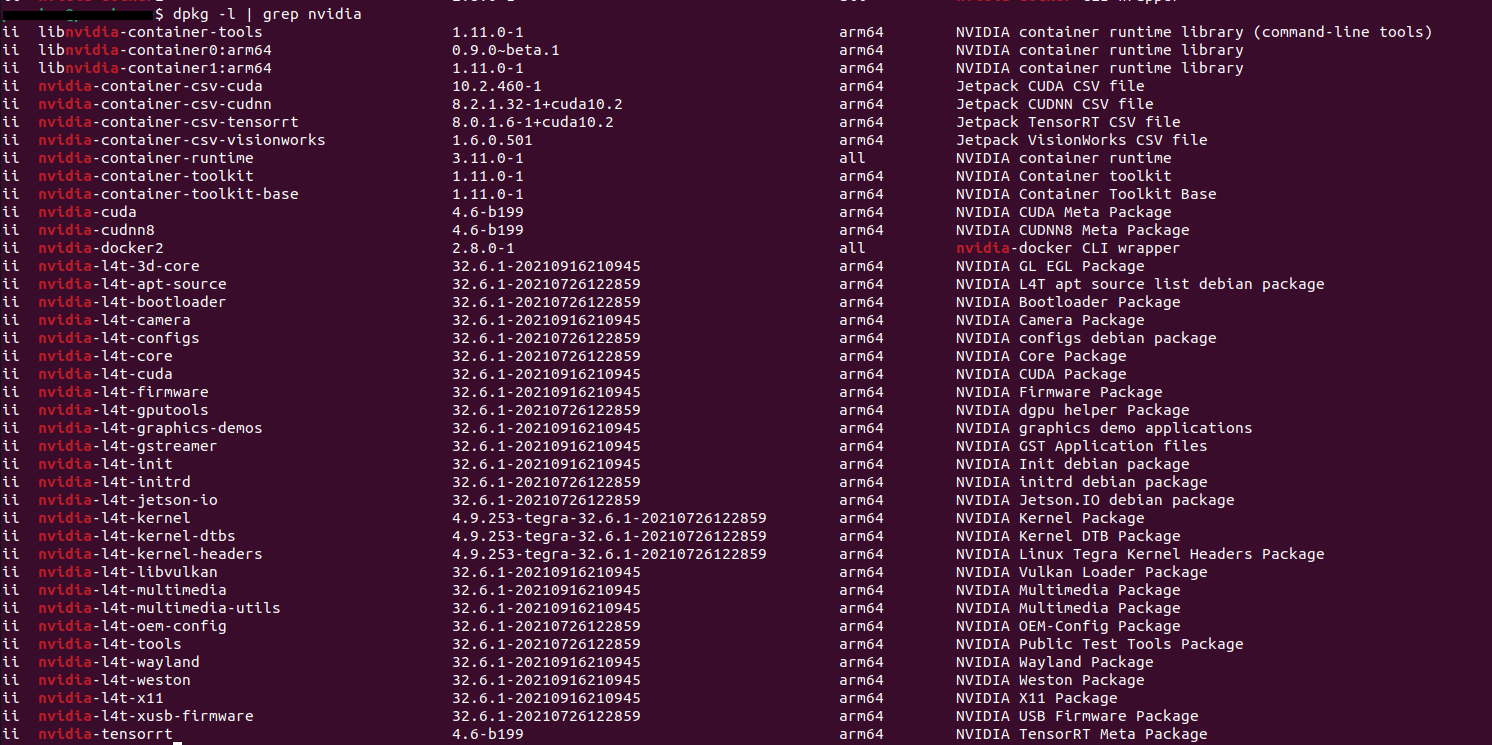

The package versions installed in my jetson tx2 are listed in the attachment.
Could it be the package version incompatibility issue? Because I saw someone mentioned here:
libcudart.so.10.2 is not available in tensorflow image · Issue #146 · dusty-nv/jetson-containers · GitHub.

OK, sorry that it appears that the mounting is not working correctly. Typically I would recommend reinstalling the nvidia-container-* packages or re-flashing the device to get those working again.
