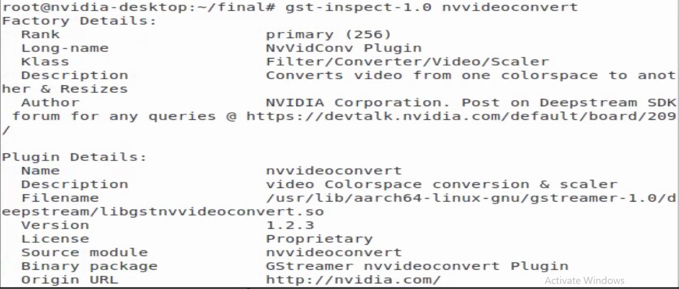

Can “gst-inspect-1.0 nvvideoconvert” get correct result in host?
Yes its working inside host

Seems the command is OK. Please try the instruction in this link: DeepStream-l4t | NVIDIA NGC
I am following the instructions from this link it does not solves the issue because there is no issue with running the container because I have installed deepstream properly by following the link you provided and I get same error whether I run the command inside the container or just normally.
It is the same error which I was getting by running the command inside the deepstream container. I dont think there is any issue with deepstream and its installation.
