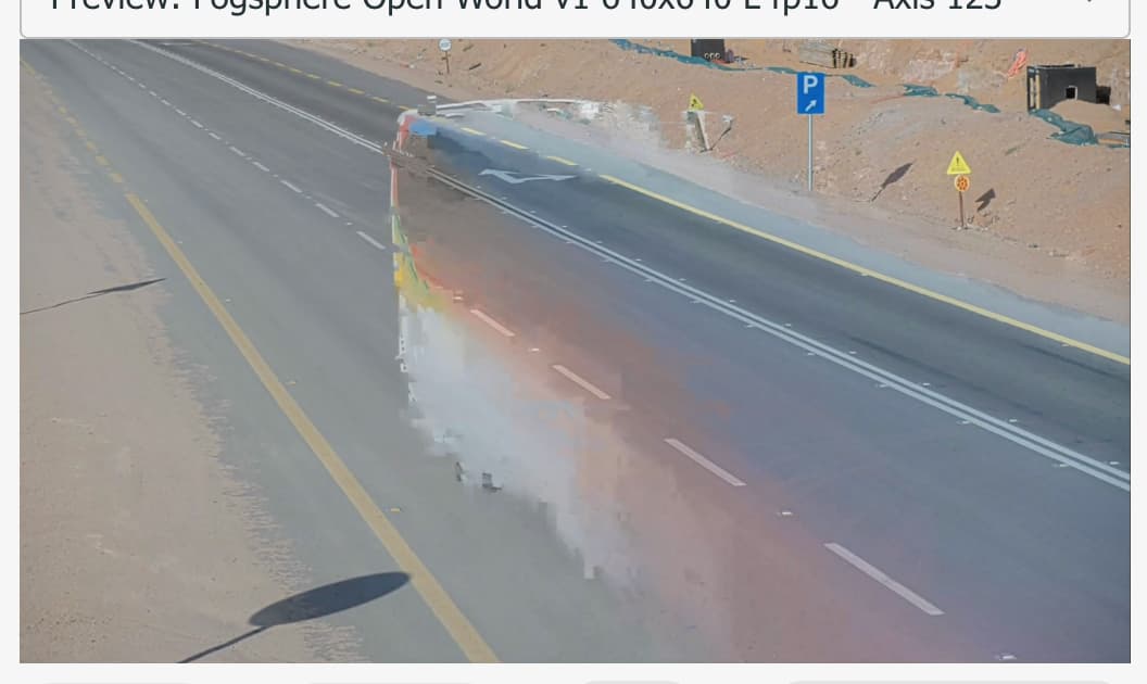

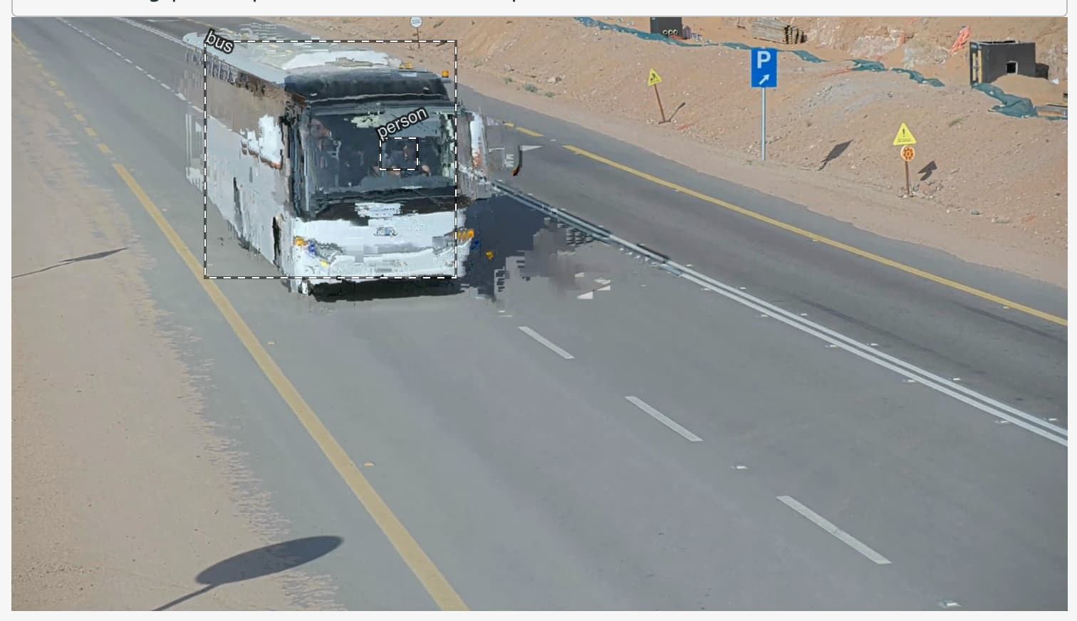

Nvurisrcbin lead rtsp input frames to disorted (jitter effect)
• Hardware Platform GPU
• DeepStream Version 7.1
• NVIDIA GPU Driver Version 535.183.01
• Issue Type rtsp input frame is disorted
**• How to reproduce the issue ? I have attached the code
nvurisrcbin → lead to input frame distorted
uridecodebin → no problem in reading input frame
rtspsrc → no problem in reading input frame
  • I tried to use nvurisrcbin for rtsp reconnection property, the reconnection property is working fine but when reading frame from rtsp, lead to disorted frame (jitter effect) how to resolve it.
  • When I try to replace with uridecodebin it works fine no distorted or jitter effect
  • I tried paralley running nvurisrcbin and uridecodebin, the same frame uridecodebin is working but nurisrcbin image is distorted.

Stream #0:0: Video: h264 (Baseline), yuvj420p(pc, bt709, progressive), 1280x720, 25 fps, 25 tbr, 90k tbn, 50 tbc
i have the same issue, no jitter with uridecodebin, issues with nvurisrcbin
Are you testing the same rtsp camera on the same device at the same time? Usually this is caused by UDP packet loss.
Can you record a comparison video to help analyze this problem? Or try setting the value of the select-rtp-protocol property of nvurisrcbin to 4 (tcp)
here’s the pipelines and some example images
problematic setup, width nvumultiurisrcbin + nvmultistreamtiler + latency=200 and drop-on-latency=false
nvmultiurisrcbin select-rtp-protocol=4 rtsp-reconnect-interval=30 rtsp-reconnect-attempts=-1 port=9000 ip-address=localhost sync-inputs=0 live-source=1 attach-sys-ts=TRUE nvbuf-memory-type=3 name=multiurisrcbin drop-pipeline-eos=0 enable-padding=true max-batch-size=1 batched-push-timeout=33333 width=1920 height=1080 uri-list=rtsp://root:root@192.168.100.123:554/axis-media/media.amp?camera=1&videocodec=h264&videobitrate=1000&resolution=1920x1080&fps=15 sensor-id-list=0 sensor-name-list=mono_0

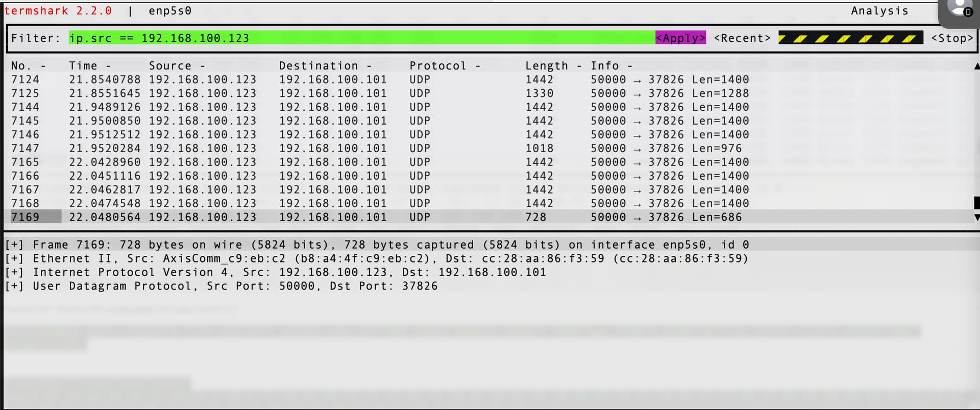

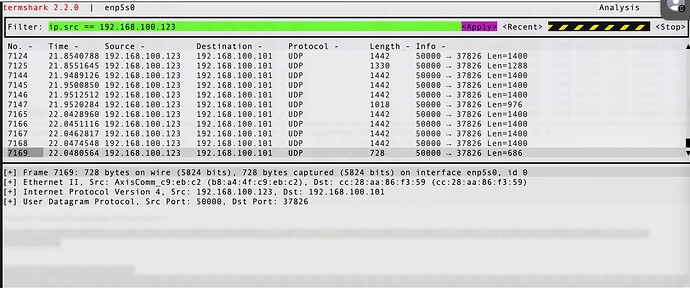

I still think this is due to UDP packet loss, although select-rtp-protocol is set to tcp(4), but it depends on whether the camera supports this feature
By the way, for your camera, is there any difference between rtsp:// vs rtspt://? Does rtspt protocol refer to rtp over tcp?
You can try to use the command to dump rtsp stream to media file to check if there is packet loss.
gst-launch-1.0 rtspsrc location=rtsp://xxxx protocols=4 ! queue ! parsebin ! queue ! h264parse ! mpegtsmux ! filesink location=rtsp.ts
yes it does, i think rtspt only indicates the rtsp client to use TCP instead of UDP
rtspt:// with uridecodebin doesn’t produce artifacts
rtsp:// with uridecodebin produces artifacts
rtpst:// with nvmultiurisrcbin doesn’t work
rtps:// with nvmultiurisrcbin + select-rtp-protocol = 4 produces artifacts
i tried with this command that produces no artifacst
gst-launch-1.0 rtspsrc location=“rtsp://root:root@192.168.100.123:554/axis-media/media.amp?camera=1&videocodec=h264&videobitrate=1000&resolution=1920x1080&fps=15” protocols=4 ! queue ! parsebin ! queue ! h264parse ! mpegtsmux ! filesink location=rtsp.ts -e
with this command instead i get artifacts
gst-launch-1.0 rtspsrc location=“rtsp://root:root@192.168.100.123:554/axis-media/media.amp?camera=1&videocodec=h264&videobitrate=1000&resolution=1920x1080&fps=15” ! queue ! parsebin ! queue ! h264parse ! mpegtsmux ! filesink location=rtsp2.ts -e
So this problem can be considered to be caused by udp packet loss.

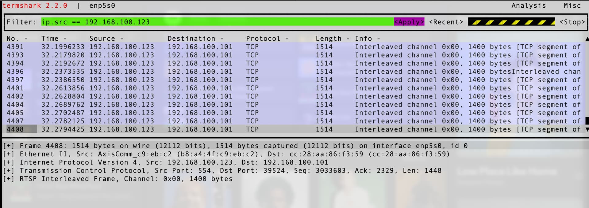

Did you set select-rtp-protocol to 4 after setting pipeline to PLAYING? This needs to be set when creating an element, otherwise it will not take effect.
I tested the following command line, nvmultiurisrcbin received the rtp over tcp packet, first confirm that you correctly received the tcp data
gst-launch-1.0 nvmultiurisrcbin port=9000 ip-address=localhost batched-push-timeout=33333 max-batch-size=1 drop-pipeline-eos=1 live-source=1 uri-list="rtsp://xxxxx" width=720 height=480 select-rtp-protocol=4 ! nvmultistreamtiler width=720 height=480 ! nv3dsink
sudo tcpdump -i eno1 src "rtsp-camera-ip" -vv -s 0
  1. i’m setting select-rtp-protocol to 4 directly into the pipeline string (i launch gst python with the pipeline string parsing option)
do i have to catch the rtsp element into the child-added and set select-rtp-protocol in some child of multiurisrcbin?
  1. how can i dump this output to a file like the previous examples to see if it jitters?
gst-launch-1.0 nvmultiurisrcbin port=9000 ip-address=localhost batched-push-timeout=33333 max-batch-size=1 drop-pipeline-eos=1 live-source=1 uri-list=“rtsp://xxxxx” width=720 height=480 select-rtp-protocol=4 ! nvmultistreamtiler width=720 height=480 ! nv3dsink
thank you!
No need to do this.
If this command does not jitter effect, and the packets captured by tcpdump are TCP packets, it proves that the configuration is effective.
I think as long as the input is TCP, there will be no packet loss and no jitter effect.
