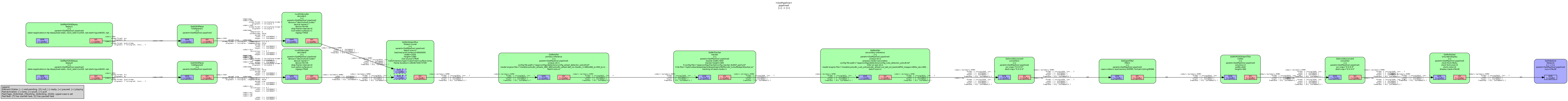

Pixelated Frames in Deepstream Pipeline
• Hardware Platform (Jetson / GPU) Jetson
• DeepStream Version (6.3 & 7.0)
• JetPack Version (valid for Jetson only) (5.1.3 & 6.0)
• TensorRT Version
I am using the deepstream-imagedata-multistream sample application without any pgie element. It works when I run it on sample video sample_1080p_h264.mp4 but when I run it pipeline with rtsp camera the frame gets pixelated.
I have tried to run the sample video as rtsp using the this script

This is the pixelated frames from the pipeline on rtsp url generated by above script
Can you guide me how can I fix this issue? and I have tried it on Deepstream 6.3 with Jetpack 5.1.3 and Deepstream 7.0 with Jetpack 6.0
This doesn’t seem to be a DeepStream issue. It’s more like a gstreamer rtsp server problem. You can file the topic on the Gstreamer forum. Thanks
I have built the Gstreamer from source but still facing the same issue
What do you mean by built the Gstreamer from source? Since you are using the native plugins of Gstreamer, not the NV plugins. So this problem is most likely a Gstreamer rtspserver problem, you’d better file the topic on the Gstreamer forum.

Pipeline with Default Component
Pipeline with rtspsrc component
Pipeline with rtspsrc with working on x86 with deepstream 7.0, but on jetson FPS drops to 0 after few minutes
From the pipeline graph, you set the batched-push-timeout to 8000000. That might be the reason for the 0 fps on the Jetson.
And for the pixelated issue, you can try to set the protocols of the rtspsrc to 4.
Pipeline with rtspsrc component and tcp protocol is working, but the default deepstream pipeline still has that pixelated issue.
Have you set the protocol to 4 according to the #16? You can refer to Source group to set the related parameters.
Because your pipeline graph is got when the pipeline transfers the state from pause to play, it does not get the source plugin. You can try to get the graph when the pipeline is at the playing state.
