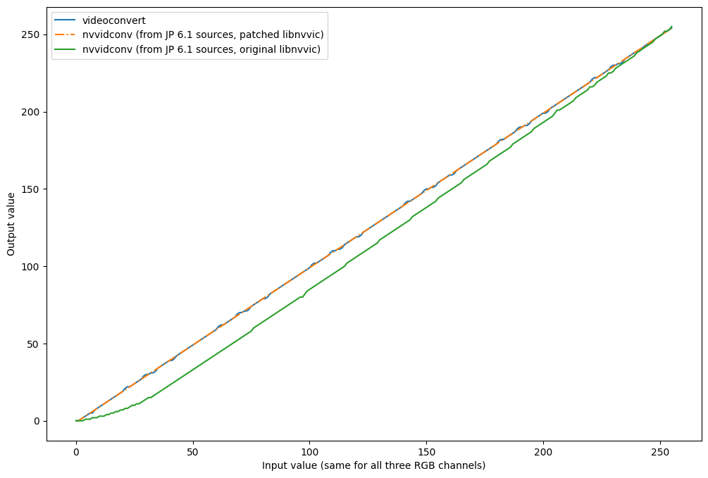

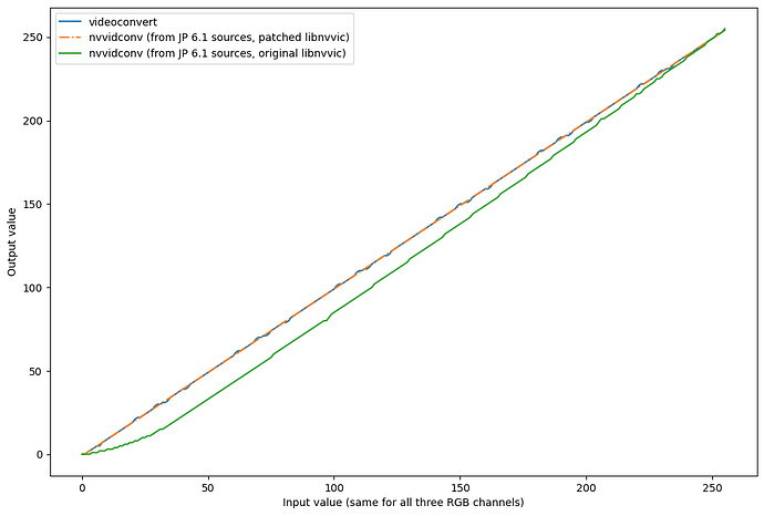

We can get the extended range to work when we use the JP 6.1 sources as suggested in the other post. However, we then see a similar nonlineear curve (see image below). Additionally also using the patched libnvvic.so from the other post fixes the issue on the gradient:

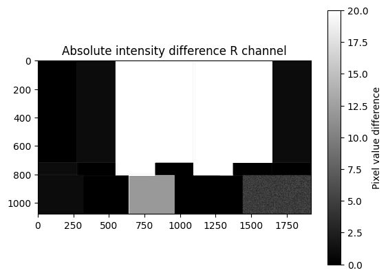

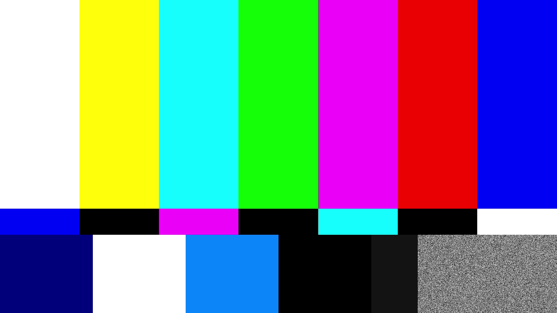

However, when we use this setup (nvvidconv from JP6.1 sources + patched nvvic) to create the default videotestsrc, the image is still significantly darker when using nvvidconv (also when using interpolation-method=Nicest).
# videoconvert
gst-launch-1.0 videotestsrc ! 'video/x-raw,width=1920,height=1080,framerate=5/1,format=RGBA' ! videoconvert ! jpegenc ! multifilesink location=jpg_write/frame_%04d.jpg
# nvvidconv
gst-launch-1.0 -v videotestsrc ! 'video/x-raw,width=1920,height=1080,framerate=5/1,format=RGBA' ! videoconvert ! nvvidconv ! 'video/x-raw(memory:NVMM),format=(string)NV12,colorimetry="1:3:0:0"' ! nvvidconv ! jpegenc quality=95 ! multifilesink location=jpg_nvvidconv_write/frame_%04d.jpg
videoconvert
nvvidconv
Plotting the absolute intensity difference per pixel for the two images above (white being an absolute value difference of 20 or more, where we see differences that go much higher).
For us it is important to keep the color information across the full range. Are we missing something in our setup? Is thee an issue with nvvidconv or is this expected behavior?
