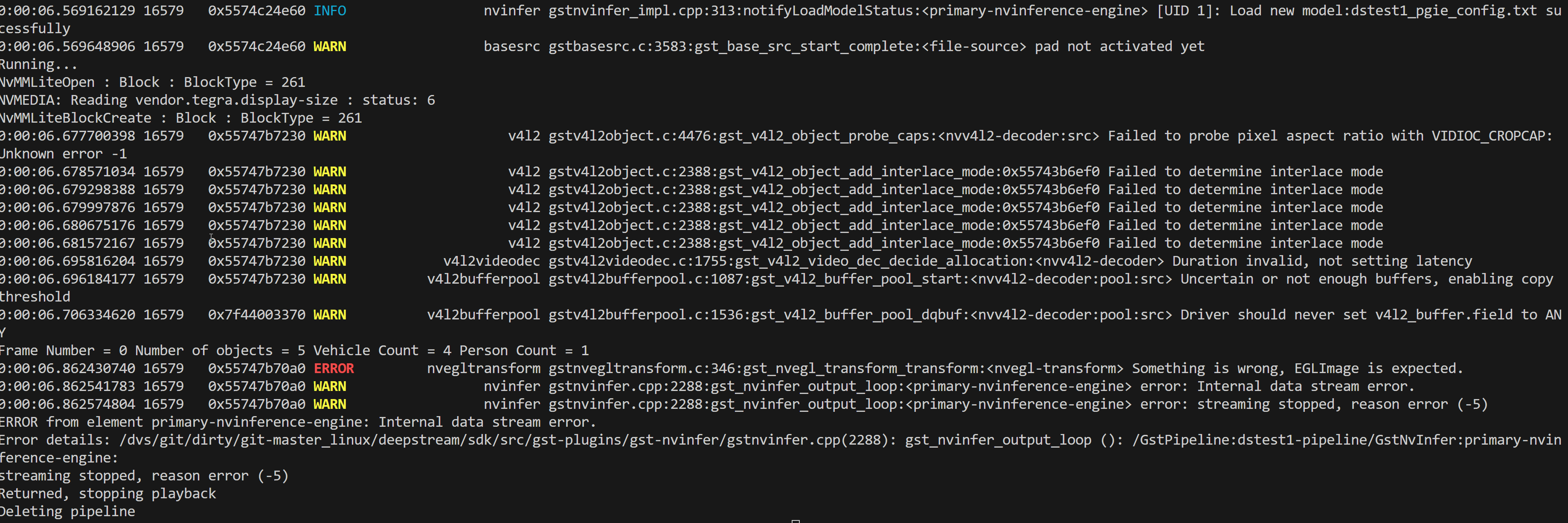

An error occurs when running deepstream-test1.
After I replaced nveglglessink with fakesink, the log is as follows:
Looking forward to your reply, thank you!
Is this jetson nano plugged into a monitor?
Or are you running the program via ssh? If you run the program via ssh, set the DISPLAY variable
cat /proc/*/environ 2>/dev/null | tr '\0' '\n' | grep '^DISPLAY=:' | uniq
If you are using fakesink you can remove the nvegltransform element
