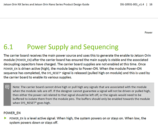

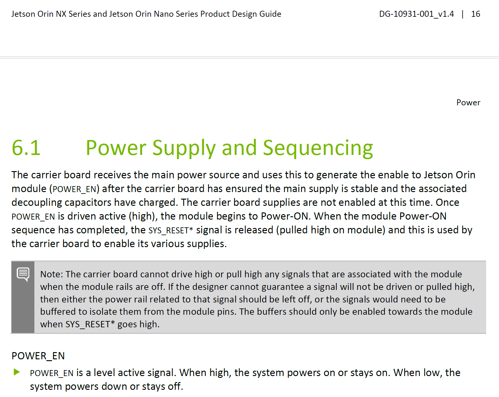

If question is related to Power ON/OFF of Jetson Orin Nano, please refer to Power Supply and Sequencing section in the Jetson Orin NX Series and Orin Nano Series Design Guide https://developer.nvidia.com/downloads/jetson-orin-nx-series-nano-series-design-guide

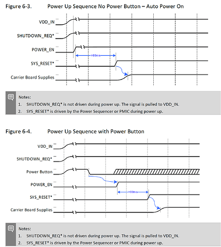

Hello Wayne! Glad to see a moderator in here. I really do need the help! The switch in this term, is more like a on/off switch that controls the power supply to the NVIDIA. Basically, what I want is a way to control the code in NVIDIA so that if I turn the NVIDIA off using a switch, the code will restart after I turn it back on. However, I don’t want to damage the NVIDIA or possibly burn it. The main problem is simply I don’t have a solution for having a on/off switch to control NVIDIA.
Did you check Power Button Supervisor MCU used on Jetson Orin Nano carrier board? This might help if your purpose is to turn ON/OFF the Jetson module using a push button.
