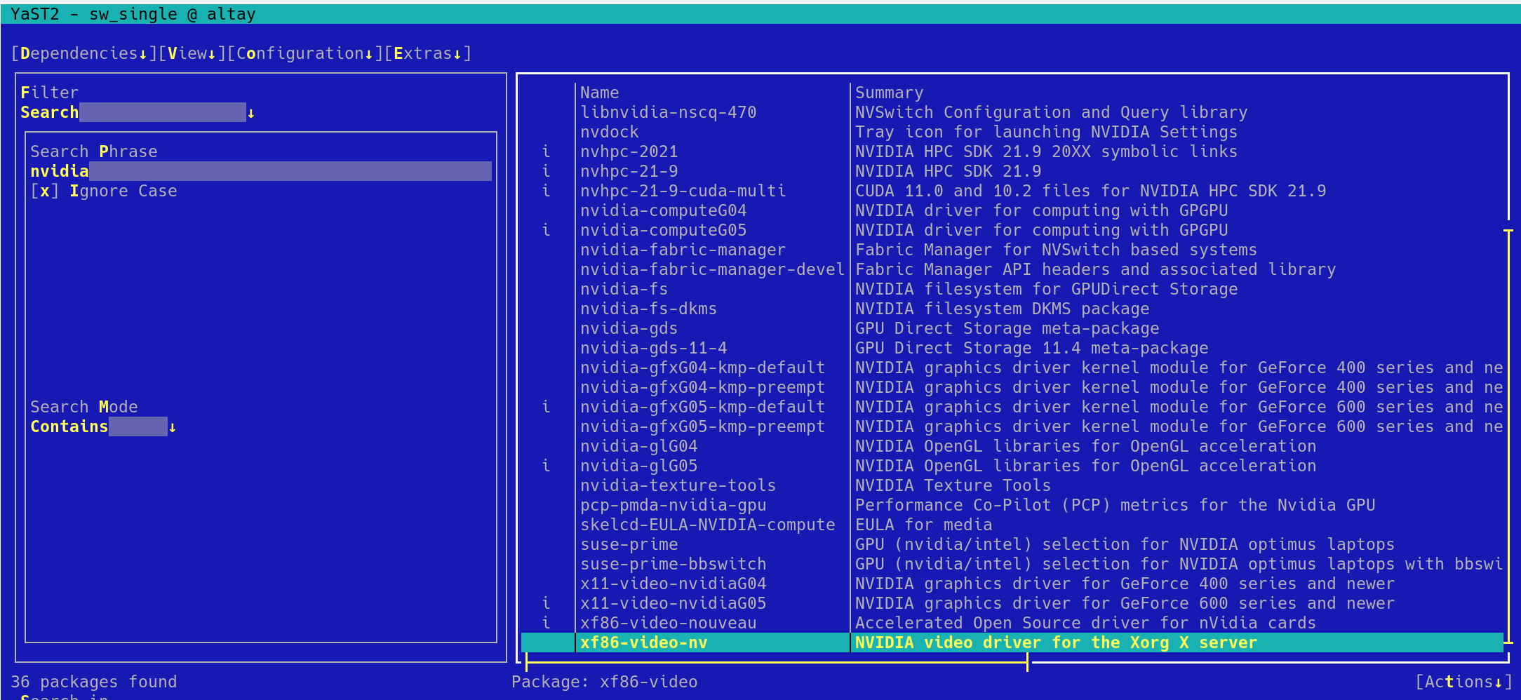

The installed tools are below. I am not sure whether it is helpful or not but these are what I installed to the computer.

Hi Yunus,
Since you got output from nvaccelinfo, this means the CUDA driver installation is fine. So most likely the issue is that the device code is being run on the P620 rather than the GV100. Although the device enumeration is correct in the nvaccelinfo output, the CUDA driver may be reversing these on launch.
To test this theory, try setting the environment “CUDA_VISIBLE_DEVICE=1” to see if that fixes the issue.
