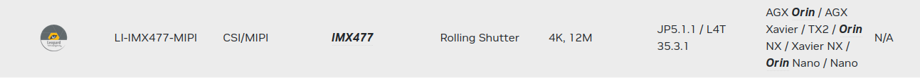

I thought that the JetPack version can be a problem, because the NVIDIA document says that LI-IMX477-MIPI works with JetPack 5.1.2.
However, I think at least the GPIO in J20 should be lighted up.(or can it be a JetPack version problem?)

hello jwna1885,
had you port the device tree settings, since IMX477 is not supported with AGX Orin by default.
please integrate the device tree from Orin NX to AGX Orin.
