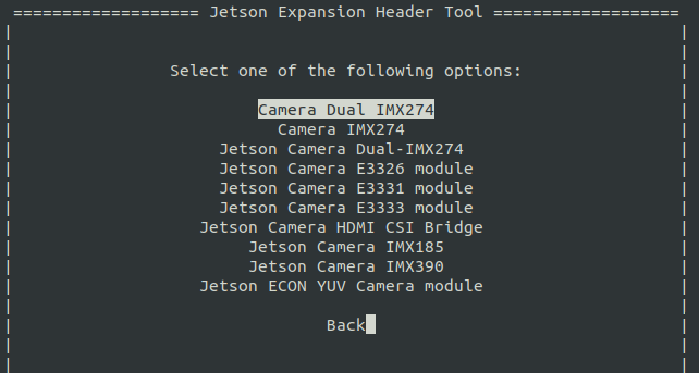

I am working with a Jetson AGX Xavier board with Jetpack 5.1 and attempting to use an IMX477 sensor camera with the board.

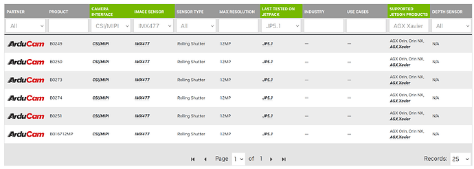

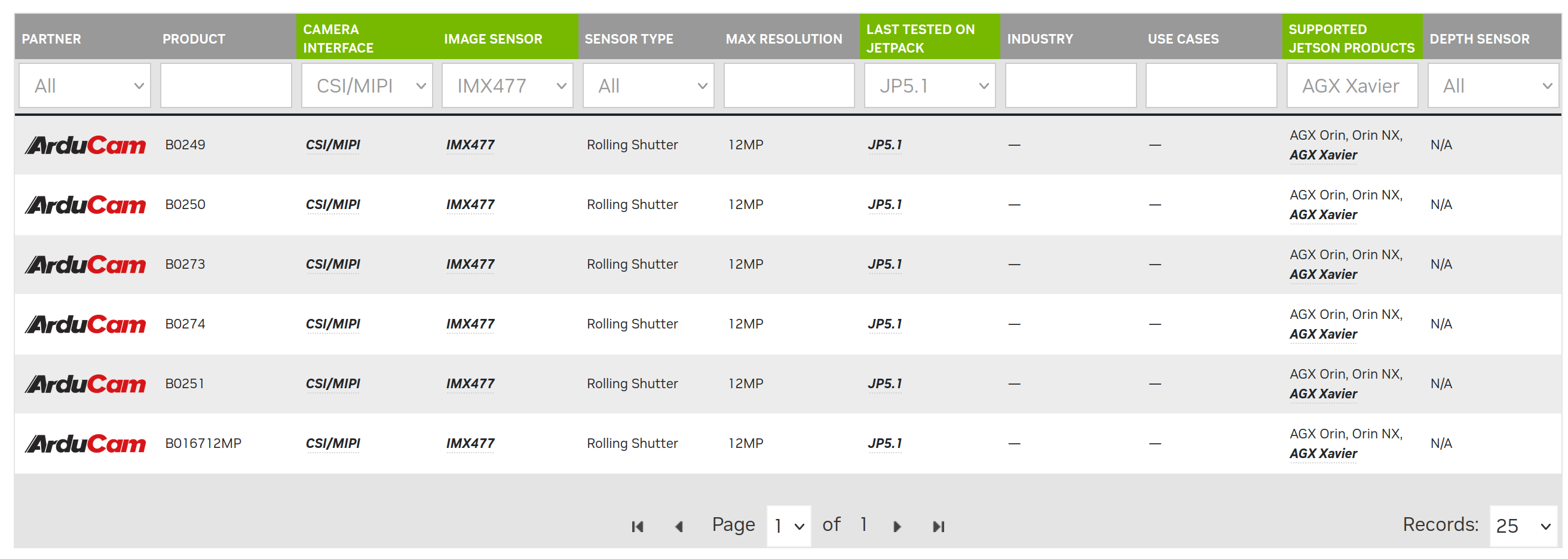

I have checked the list of Jetson Partner Supported Cameras and it showed multiple IMX477 cameras as compatible with AGX Xavier:
(Although looking up these models on store pages show that they are not listed as compatible with AGX Xavier.)
Using the jetson-io interface I don’t see IMX477 as an option:

Is there a way for me to use any model of IMX477 camera with Jetson AGX Xavier? Is the list screenshotted above just not accurate?
I’ll be grateful for any and all advice you can give me.
For IMX477 need device tree configure for AGX Xavier.
