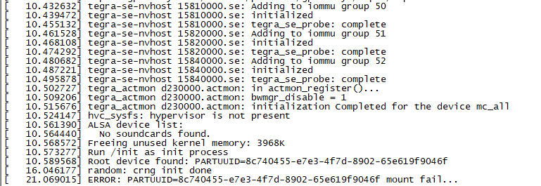

Hi, we are using our self-developed carrier board with an ORIN NX 16G SOM. L4T:35.4.1,JETPACK:5.1.2, We plan to clone an existing intact system. Using the following commands:
sudo ./tools/backup_restore/l4t_backup_restore.sh -e nvme0n1 -b jetson-orin-nano-devkit
sudo ./tools/backup_restore/l4t_backup_restore.sh -e nvme0n1 -r jetson-orin-nano-devkit,
backup and restore command work properly, but during the restored nvme startup, the screen goes black. Observing via UART, the following error appears:
[ 12.334246] random: crng init done
[ 22.795150] ERROR: PARTUUID=8c740455-e7e3-4f7d-8902-65e619f9046f mount fail…
uart_boot.log (156.4 KB)
According to this post ERROR: PARTUUID=bbc76f97-xxxx-xxxxx-xxxx-92697925be65 mount fail,
Modify the content of the file Linux_for_Tegra/bootloader/l4t-rootfs-uuid.txt to 1e5a432c-0466-4d31-b009-d4d9239271d3 ,after executing command:
sudo ./flash.sh --reuse-uuid jetson-orin-nano-devkit internal
it shows that the command cannot be executed, probably because the --reuse-uuid option is invalid. Please provide assistance.

Could you provide the backup/restore log and record the serial console log at the same time?

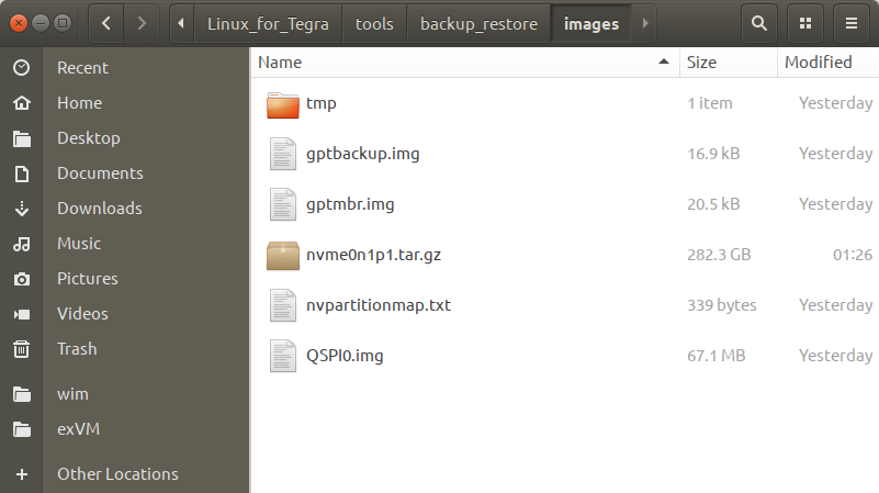

In order to obtain the log, I performed the backup operation again,
but it seems like the backup didn’t complete before exiting. I tried twice, and the same issue occurred both times.
and the backuped file should be greater than 600GB, but it is only less than 300GB.

Since you are using the r35.4.1, please refer to
Thanks for your reply. following the method above, I successfully performed the backup and restore process, but the restored system still can’t boot, showing an error that the PARTUUID cannot be found.
the PARTUUID=8c740455-e7e3-4f7d-8902-65e619f9046f is the backuped nvme0n1p1’s
flash_1-1_0_20250808-193127.log (6.2 KB)
flash_1-1_0_20250808-203236.log (6.1 KB)
uart_boot.log (88.8 KB)
Please provide suggestions.
Hi.
Just to confirm — did you place your device into Recovery Mode before running the backup and restore process?
We’ve noticed that your backup log looks quite different from ours.
yes, it is in recovery mode, and get the backup files successfuly as follows:
Is your host a ubuntu or a windows?
Do you use the vm to run ubuntu?
Yes, I am using a virtual machine system in WIN10, and it is running Ubuntu 18.04.
We recommend preparing a native Ubuntu environment, as virtual machines can sometimes cause issues during the flashing/restore process.
Using a native Ubuntu system will allow us to better focus on resolving your backup restore issue.
