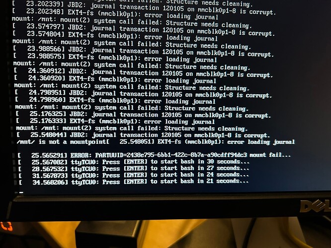

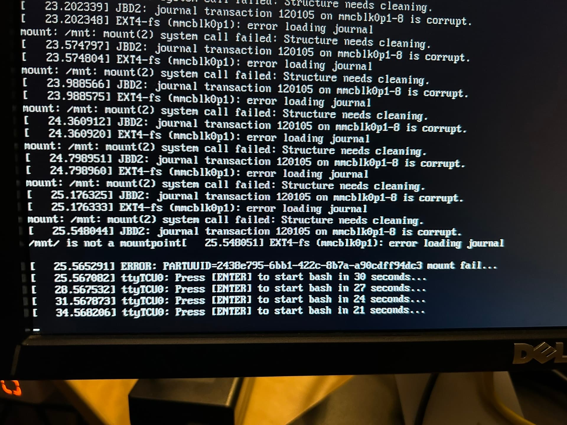

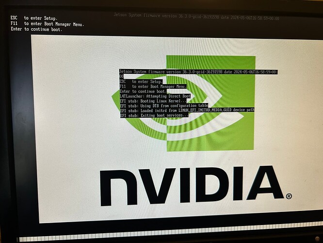

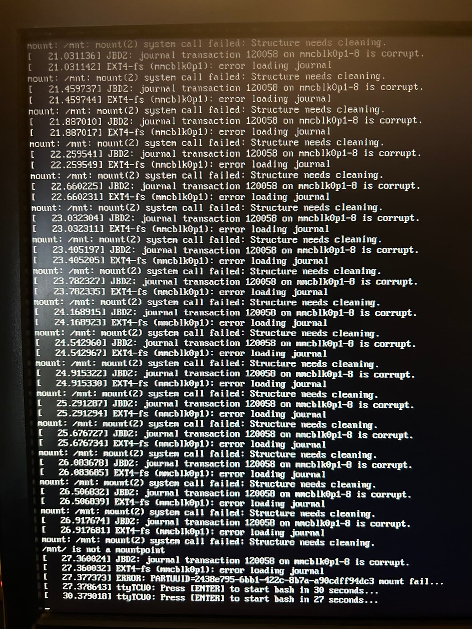

The newly restored systems will not fully boot into the OS as it complains of ext4-fs errors and journal errors, see attached images. Also included the boot screen for version information.
What am I missing? I have re-run the backup a few times and each time the restore process ends with these errors upon booting the news boxes.

Thank you but I am wondering if the backup process is not being performed correctly. Can you offer guidance on that front? Is there anything that needs to be checked or changed before running the backup command?
Please do not take pictures anymore… Use serial console to dump the log.
