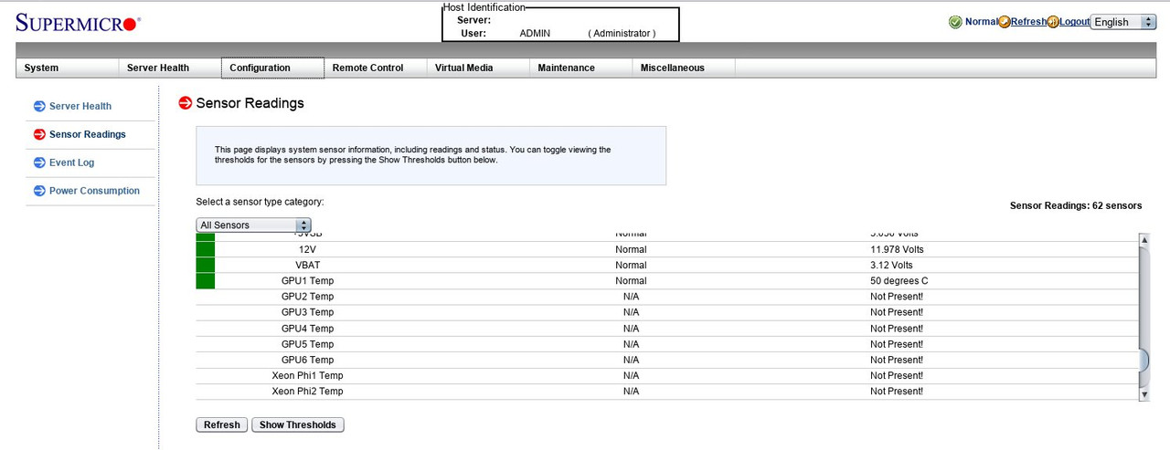

If you have server-based motherboard the temperature-fan control loop for passive cards should be automatic. Example for my IPMI Supermicro+GRID K2 with fan mode set to optimal speed:
