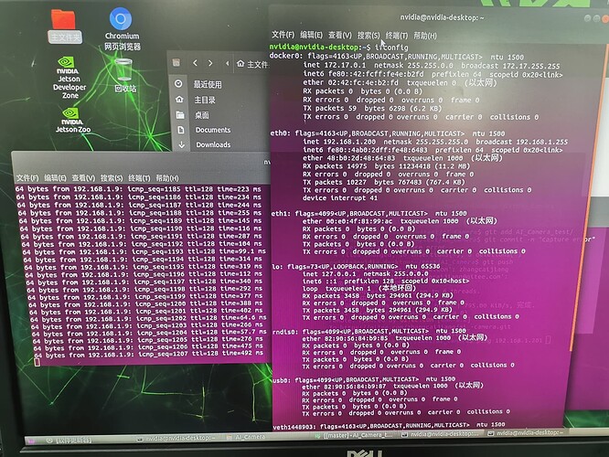

TX2 passes through the switch. When it is started up, the Ping delay is large and there is packet loss. The packet loss disappears for a period of time. Is this normal? If it is normal, how long will it take to alleviate packet loss? If not normal, how should we solve it?
Please try to clarify the network environment and software environment when you file a post.
Also, please use devkit to reproduce the issue too.
Under “ifconfig”, which interface is it? For that interface, after you’ve had a period of loss and it starts working again, post the output of that interface’s “ifconfig” and also post the output of the “route” command.
ethtool -s eth0 speed 100 duplex full autoneg off

在我們看來你只說了 “TX2接一個switch, 然後一開始會有packet drop”.
基本上你完全沒有澄清到我上面任何問題, 我講白一點. linuxdev回答你的東西基本上就是一些基本的ubuntu網路指令
今天你只是剛好運氣好可以ethtool改一改之後就能動了
但說實話 你現在的方法在我看來比較像是workaround, 不是solution, 拿我這邊的TX2跟網路環境舉例好了 我可以 “ethtool -s eth0 speed 1000 duplex full autoneg on” 然後我也不會掉封包, 但是你的case看起來要降到100M然後 auto negotiate得關掉才能正常運作
你如果覺得這樣的設置你能接受, 我也ok 但在我看來還是有問題就是了

當你用上面這個command 設定之後你就已經寫死在100M了. 那個autoneg就是 auto negotiation的意思…
有auto negotiation 的話 Jetson 網卡就會跟你的switch溝通要用1000/100/10 哪種.
