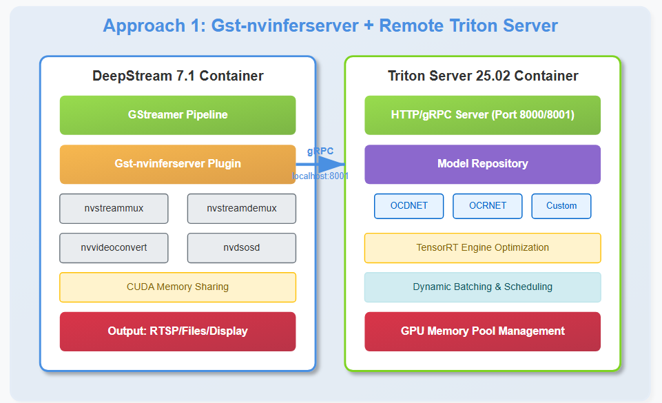

You mentioned that “DeepStream can work with Blackwell GPUs when using the Triton Inference Server as a backend instead of the native inference engine.” That caught my attention, and I’d like to understand how to make that work.
Currently, I have successfully deployed Triton Inference Server running both OCDNet and OCRNet models. However, I want to integrate this setup into DeepStream. The challenge is that I’m using a Blackwell GPU (RTX 5080), which is not supported by the default DeepStream inference engine.
If you’ve already configured the Triton Server, then you must use gst-nvinferserver instead of gst-nvinfer.
You can reference this nvinferserver configuration file as an example: deepstream_ocr/pgie-id-1-ocrnet.txt at master · levipereira/deepstream_ocr · GitHub
deepstream_ocr/pipeline.py at 818d2b5023311d22cdc966fb352f3352339e57f9 · levipereira/deepstream_ocr · GitHub
Important considerations:
  1. Use separate containers: You’ll need to deploy two separate containers since they require different TRT versions and dependencies.
  2. Avoid the bundled Triton Server: Don’t use the triton-server that comes with the DeepStream 7.1 container, as it’s not compatible for this use case.
  3. Deploy the correct Triton Server version: You must deploy the standalone Triton Server container version 25.02 or higher for proper functionality.

Q1: Can share the same GPU
Q2: DeepStream can be deployed the same way as on any other GPU.
The only restriction is not use gst-nvinfer but use gst-nvinferserver.
docker run \
        -it \
        --net=host \
        --ipc=host \
        --gpus all \
        nvcr.io/nvidia/deepstream:7.1-triton-multiarch
