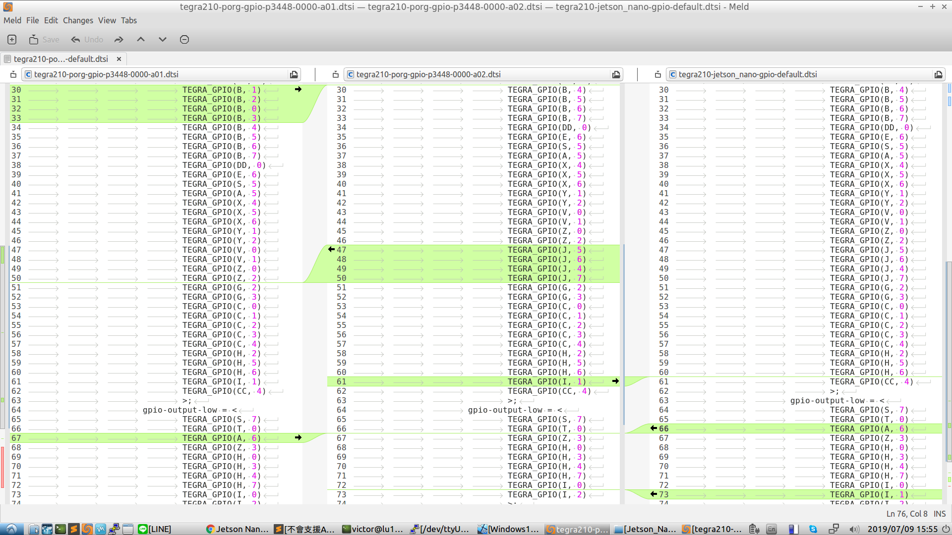

I downloaded Jetson Nano Developer Kit Pinmux spreadsheet from download center.
I didn’t change anything in the table and generated dtsi files, but I found the generated files are different from the dtsi files in L4T 32.1 source (different from tegra210-porg-gpio-p3448-0000-a01.dtsi/tegra210-porg-pinmux-p3448-0000-a01.dtsi and different from tegra210-porg-gpio-p3448-0000-a02.dtsi/tegra210-porg-pinmux-p3448-0000-a02.dtsi).
Which is the correct default setting? (My Nano uses a02)
compare data by Meld
