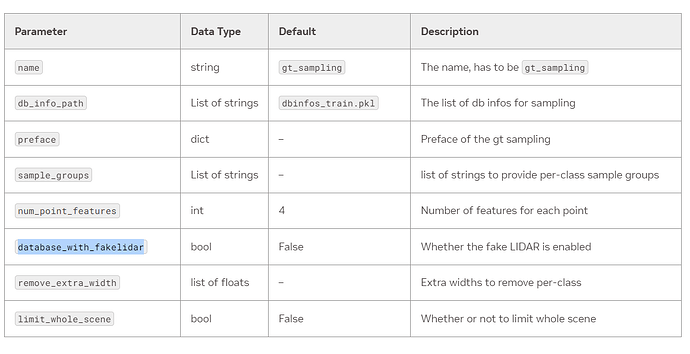

I once again looked into the document page and noticed a parameter “database_with_fakelidar”.
Regarding this here’re 2 questions:
  1. What is this parameter for? Should I set it to True if my training set contains fake lidar data as mentioned before?

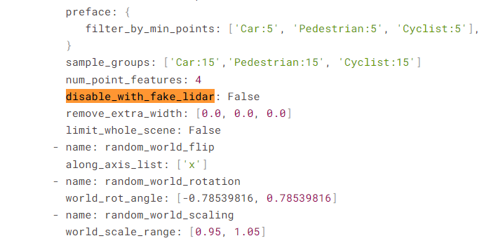

  2. The default “pointpillars.yaml” file doesn’t include this parameter. Instead, a parameter named “disable_with_fake_lidar” is included and set to False as default, but the parameter isn’t really mentioned in the document page but still shows up in the “Creating an experiment spec file” part:
The inconsistency confuses me. Which one of both is actually the parameter that exists and how am I supposed to use it?

Should be “disable_with_fake_lidar” instead of “database_with_fakelidar”. Will modify it. Thanks for the catching.
This parameter is used in tao_pytorch_backend/nvidia_tao_pytorch/pointcloud/pointpillars/pcdet/datasets/augmentor/database_sampler.py at 6f802c93a32aad69a155c86d941c1ea84fe2fc4e · NVIDIA/tao_pytorch_backend · GitHub.
If set it to False, it will run 1https://github.com/NVIDIA/tao_pytorch_backend/blob/6f802c93a32aad69a155c86d941c1ea84fe2fc4e/nvidia_tao_pytorch/pointcloud/pointpillars/pcdet/utils/box_utils.py#L136-L147
tao_pytorch_backend/nvidia_tao_pytorch/pointcloud/pointpillars/pcdet/utils/box_utils.py at 6f802c93a32aad69a155c86d941c1ea84fe2fc4e · NVIDIA/tao_pytorch_backend · GitHub to make the change against the boxes.
If set to True, it will not make the change.
The default is False, so that means z gets changed everytime I train the model ?
It should have been set True if I don’t want the value of z modified ?
