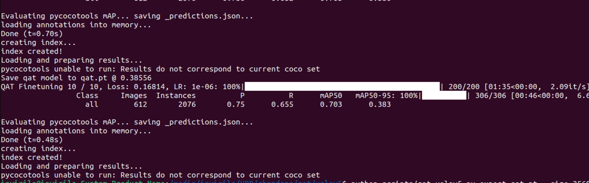

I followed https://github.com/NVIDIA-AI-IOT/yolo_deepstream/tree/main/yolov7_qat and somehow lost all the detections that I was previously getting. I used the qat.onnx one, what could possibly be going wrong here? i was getting this issue while running the quantize command, is that going to affect anything? @Fiona.Chen
