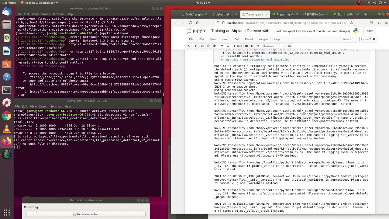

Im running the TLT3 jupyter notebook and I have got hung up because it cant find the path to “tlt_pretrained_detectnet_v2_vresnet18/resnet18.hdf5”
here is a video that explains it better
@adventuredaisy This is interesting, could you try running
tlt detectnet_v2 run "/bin/sh"
This let’s you shell into the docker container. At this point you can navigate the file system to see if everything is mounting properly. e.g.
ls -altr tlt-experiments/tlt_pretrained_detectnet_v2_vresnet18
Let me know if the file is accessible through the docker container then we can figure out which direction to take our debugging.
Here is a video of me running the suggestions from your post
Thank you
OK looks like this is working now
!tlt detectnet_v2 train --key tlt --gpu_index 0

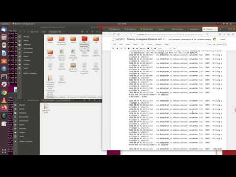

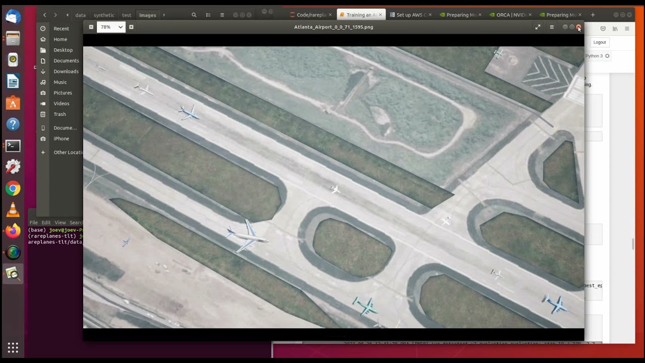

Only thing I came across that my be issue is when I run this:
convert_split(‘kitti_synthetic_train’)
It seems like it cant find a picture
Matplotlib created a temporary config/cache directory at /tmp/matplotlib-afk40id4 because the default path (/.config/matplotlib) is not a writable directory; it is highly recommended to set the MPLCONFIGDIR environment variable to a writable directory, in particular to speed up the import of Matplotlib and to better support multiprocessing.
Using TensorFlow backend.
WARNING:tensorflow:Deprecation warnings have been disabled. Set TF_ENABLE_DEPRECATION_WARNINGS=1 to re-enable them.
2021-06-21 12:28:10,764 - iva.detectnet_v2.dataio.build_converter - INFO - Instantiating a kitti converter
2021-06-21 12:28:16,463 - iva.detectnet_v2.dataio.kitti_converter_lib - INFO - Num images in
Train: 44550 Val: 450
2021-06-21 12:28:16,463 - iva.detectnet_v2.dataio.kitti_converter_lib - INFO - Validation data in partition 0. Hence, while choosing the validationset during training choose validation_fold 0.
2021-06-21 12:28:16,500 - iva.detectnet_v2.dataio.dataset_converter_lib - INFO - Writing partition 0, shard 0
WARNING:tensorflow:From /home/vpraveen/.cache/dazel/_dazel_vpraveen/216c8b41e526c3295d3b802489ac2034/execroot/ai_infra/bazel-out/k8-fastbuild/bin/magnet/packages/iva/build_wheel.runfiles/ai_infra/iva/detectnet_v2/dataio/dataset_converter_lib.py:142: The name tf.python_io.TFRecordWriter is deprecated. Please use tf.io.TFRecordWriter instead.
2021-06-21 12:28:16,500 - tensorflow - WARNING - From /home/vpraveen/.cache/dazel/_dazel_vpraveen/216c8b41e526c3295d3b802489ac2034/execroot/ai_infra/bazel-out/k8-fastbuild/bin/magnet/packages/iva/build_wheel.runfiles/ai_infra/iva/detectnet_v2/dataio/dataset_converter_lib.py:142: The name tf.python_io.TFRecordWriter is deprecated. Please use tf.io.TFRecordWriter instead.
/usr/local/lib/python3.6/dist-packages/iva/detectnet_v2/dataio/kitti_converter_lib.py:273: VisibleDeprecationWarning: Reading unicode strings without specifying the encoding argument is deprecated. Set the encoding, use None for the system default.
2021-06-21 12:28:19,905 - iva.detectnet_v2.dataio.dataset_converter_lib - INFO - Writing partition 0, shard 1
2021-06-21 12:28:22,604 - iva.detectnet_v2.dataio.dataset_converter_lib - INFO - Writing partition 0, shard 2
2021-06-21 12:28:25,107 - iva.detectnet_v2.dataio.dataset_converter_lib - INFO - Writing partition 0, shard 3
2021-06-21 12:28:27,343 - iva.detectnet_v2.dataio.dataset_converter_lib - INFO - Writing partition 0, shard 4
File “/home/vpraveen/.cache/dazel/_dazel_vpraveen/216c8b41e526c3295d3b802489ac2034/execroot/ai_infra/bazel-out/k8-fastbuild/bin/magnet/packages/iva/build_wheel.runfiles/ai_infra/iva/detectnet_v2/scripts/dataset_convert.py”, line 90, in
File “/home/vpraveen/.cache/dazel/_dazel_vpraveen/216c8b41e526c3295d3b802489ac2034/execroot/ai_infra/bazel-out/k8-fastbuild/bin/magnet/packages/iva/build_wheel.runfiles/ai_infra/iva/detectnet_v2/scripts/dataset_convert.py”, line 86, in main
File “/home/vpraveen/.cache/dazel/_dazel_vpraveen/216c8b41e526c3295d3b802489ac2034/execroot/ai_infra/bazel-out/k8-fastbuild/bin/magnet/packages/iva/build_wheel.runfiles/ai_infra/iva/detectnet_v2/dataio/dataset_converter_lib.py”, line 71, in convert
File “/home/vpraveen/.cache/dazel/_dazel_vpraveen/216c8b41e526c3295d3b802489ac2034/execroot/ai_infra/bazel-out/k8-fastbuild/bin/magnet/packages/iva/build_wheel.runfiles/ai_infra/iva/detectnet_v2/dataio/dataset_converter_lib.py”, line 105, in _write_partitions
File “/home/vpraveen/.cache/dazel/_dazel_vpraveen/216c8b41e526c3295d3b802489ac2034/execroot/ai_infra/bazel-out/k8-fastbuild/bin/magnet/packages/iva/build_wheel.runfiles/ai_infra/iva/detectnet_v2/dataio/dataset_converter_lib.py”, line 146, in _write_shard
File “/home/vpraveen/.cache/dazel/_dazel_vpraveen/216c8b41e526c3295d3b802489ac2034/execroot/ai_infra/bazel-out/k8-fastbuild/bin/magnet/packages/iva/build_wheel.runfiles/ai_infra/iva/detectnet_v2/dataio/kitti_converter_lib.py”, line 173, in _create_example_proto
File “/home/vpraveen/.cache/dazel/_dazel_vpraveen/216c8b41e526c3295d3b802489ac2034/execroot/ai_infra/bazel-out/k8-fastbuild/bin/magnet/packages/iva/build_wheel.runfiles/ai_infra/iva/detectnet_v2/dataio/kitti_converter_lib.py”, line 212, in _example_proto
File “/home/vpraveen/.cache/dazel/_dazel_vpraveen/216c8b41e526c3295d3b802489ac2034/execroot/ai_infra/bazel-out/k8-fastbuild/bin/magnet/packages/iva/build_wheel.runfiles/ai_infra/iva/detectnet_v2/dataio/kitti_converter_lib.py”, line 206, in _get_image_size
File “/usr/local/lib/python3.6/dist-packages/PIL/Image.py”, line 2766, in open
fp = builtins.open(filename, “rb”)
FileNotFoundError: [Errno 2] No such file or directory: ‘/workspace/tlt-experiments/data/kitti/synthetic_train/images/Miami_Airport_0_0_200_25266.png’
File “/usr/local/bin/detectnet_v2”, line 8, in
sys.exit(main())
File “/home/vpraveen/.cache/dazel/_dazel_vpraveen/216c8b41e526c3295d3b802489ac2034/execroot/ai_infra/bazel-out/k8-fastbuild/bin/magnet/packages/iva/build_wheel.runfiles/ai_infra/iva/detectnet_v2/entrypoint/detectnet_v2.py”, line 12, in main
File “/home/vpraveen/.cache/dazel/_dazel_vpraveen/216c8b41e526c3295d3b802489ac2034/execroot/ai_infra/bazel-out/k8-fastbuild/bin/magnet/packages/iva/build_wheel.runfiles/ai_infra/iva/common/entrypoint/entrypoint.py”, line 296, in launch_job
AssertionError: Process run failed.
2021-06-21 05:28:30,000 [INFO] tlt.components.docker_handler.docker_handler: Stopping container.
@adventuredaisy
-use_amp would only work on GPUs that have support for mixed precision training. Can I ask which GPU you are trying this on?
As for the image file, can you confirm that it was downloaded to your local disk. e.g., I saved it here: ls -altr ~/Data/rareplanes-public/kitti/synthetic_train/images/Miami_Airport_0_0_200_25266.png
If it’s not there, you might want to try redownloading from s3. If it is, we need to verify that the file is accessible in the docker container.
Create a shell into the docker container like before: tlt detectnet_v2 run "/bin/sh"
Then we check it the file is available through the docker container: ls -altr tlt-experiments/data/kitti/synthetic_train/images/Miami_Airport_0_0_200_25266.png
If it’s not there, try and cd into the folders under tlt-experiments and see if any of the images are making it through at all.
