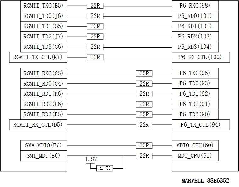

Problem about replacing PHY of Xavier with a Switch
Hi,we are replacing the PHY(Marvell 88E1512) of Xavier with a Switch(Marvell 88E6352),and the switch connect with Xavier through RGMII and SMI(MDC/MDIO) interface .
But RGMII communication is not successful,the Switch can only be detected a few times(about 1/10) through SMI interface ,and The PHYs of the Switch can communication with each other.
Kernel configuration:
CONFIG_NET_DSA=y
CONFIG_NET_DSA_MV88E6XXX=y
CONFIG_NET_DSA_MV88E6XXX_GLOBAL2=y
then compiling and flashing…I can find the mv88e6085 in /sys/bus/mdio_bus/drivers/.

1.I can find fixed-0:00 in /sys/bus/mdio_bus/devices/.
2.Log of kernel: eth0:Link is Up – 1Gbps/full -flow control off.
3.Can configure IP address,but ping is not successful,only have TX packets,no RX packets.

Could you share the full boot log and device tree?
This is device tree src/hardware/nvidia/platform/t19x/common/kernel-dts/t19x-common-platforms/tegra194-platforms-eqos.dtsi

[    4.393245] eqos 2490000.ether_qos: Setting local MAC: 0 4 4b cb af 67
[    4.393517] libphy: dwc_phy: probed
[    4.393572] mdio_bus dwc_phy-1:00: mdio_device_register
[    4.393772] tegra-xudc-new 3550000.xudc: device count: 1
[    4.394707] tegra-xudc-new 3550000.xudc: vbus state: 0
[    4.394862] tegra-xudc-new 3550000.xudc: entering ELPG
[    4.394935] mv88e6085 dwc_phy-1:00: switch 0x352 detected: Marvell 88E6352, revision 1
[    4.395136] tegra-xudc-new 3550000.xudc: entering ELPG done
[    4.395703] mousedev: PS/2 mouse device common for all mice
[    4.414556] tegradc 15200000.nvdisplay: hdmi: tmds rate:148367K prod-setting:prod_c_hdmi_111m_223m
[    4.421950] libphy: /ether_qos@2490000/mdio/switch0@0: probed
[    4.422491] mv88e6085: probe of dwc_phy-1:00 failed with error -22

Could you also share how you connect the Marvel switch?
For our EQOS IP Rx clock (125MHz) is feed from PHY, so we need to make sure that the Marvel switch also does the same.
Ping for #6.
The Marvel Switch can generate clock(125MHz) to Xavier RGMII RXC,and the amptitude of clock is about 150mV.
Why there is a PU on MDC line while no PU on MDIO line? Did you measure the MDC/MDIO signals to confirm the command transferred correctly?
Sorry,the PU is on MDIO,not MDC,it is error in the attachment and it is OK on the PCB board.
