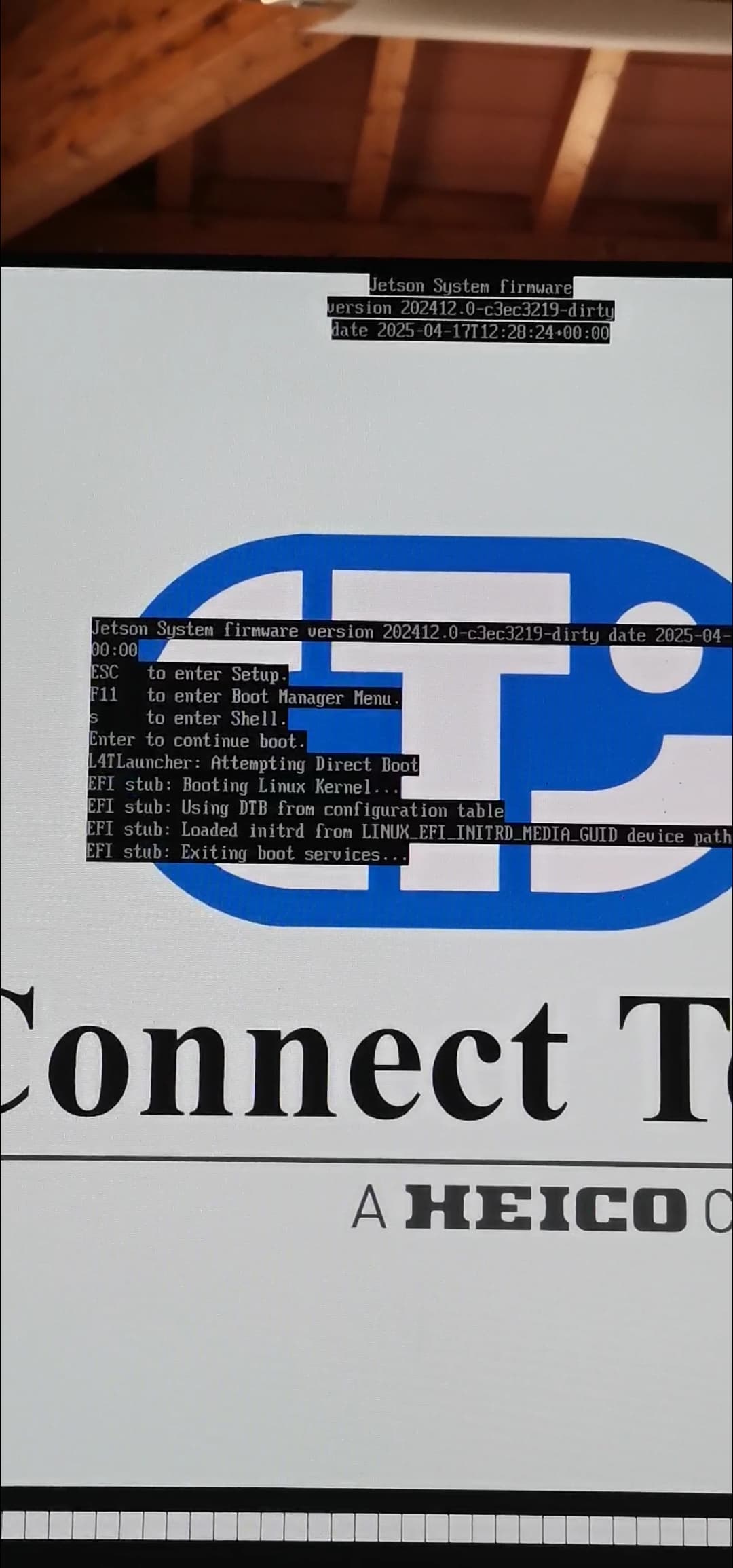

Hi everyone, it’s my first time dealing with a Jetson, so I’m not completely sure if it is even a Nano type. I’m sharing the product link below just to be sure:
(ps: sorry if I give you unnecessary details or don’t explain the problem well, but as I said, I’m new to this)
https://connecttech.com/product/photon-jetson-nano-ai-camera-platform/
This is the guide they gave me to follow, which is why I didn’t use the SDK Manager features. Instead, I followed the commands from this guide:
https://connecttech.com/resource-center/kdb373/
Everything goes fine until step 12, where I run the final flash command. Here’s the important part of the log:
flah result.txt (19.2 KB)
I also tried different flash commands such as:
# Flash rootfs on NVMe
sudo FORCE_QSPI=1 SUPER_MODE=0 ./CTI-L4T/cti-nvme-flash.sh CTI-L4T/conf/cti/orin-nano/photon/rpi-imx219
# QSPI flash
sudo ./flash.sh --qspi-only cti/orin-nano/photon/rpi-imx219 mmcblk0p1
sudo SUPER_MODE=0 ./CTI-L4T/cti-nvme-flash.sh CTI-L4T/conf/cti/orin-nano/photon/rpi-imx219
I’m sure it’s in recovery mode since lsusb gives me the correct output both before and after flashing:
post flash: picciotto@picciotto:~/nvidia/nvidia_sdk/JetPack_6.2.1_Linux_JETSON_ORIN_NANO_TARGETS/Linux_for_Tegra$ lsusb
Bus 001 Device 003: ID 8087:0a2a Intel Corp.
Bus 001 Device 038: ID 0955:7035 NVIDIA Corp. Linux for Tegra
Bus 001 Device 031: ID 30fa:0300 NVIDIA Linux for Tegra

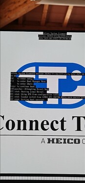

GPT said that the errors I get shouldn’t prevent it from running, but when I try to boot, after a quick screen with the ConnectTech logo it flashes these errors and then goes to a black screen:
Note: I actually did flash it correctly one time, it started and everything was fine until they gave me a camera and it couldn’t see it. After several tries i didn’t come up with any solutions but to flash it again with the options that u can see in the first rows of the file results, because in the first time I just used the base option
Thx in advance for any help
We don’t know anything about the flash tool you are using there which is provided by ConnectTech.
Please check with ConnectTech if you want to flash their carrier board.
We only support NV devkit with official tool.
