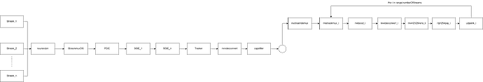

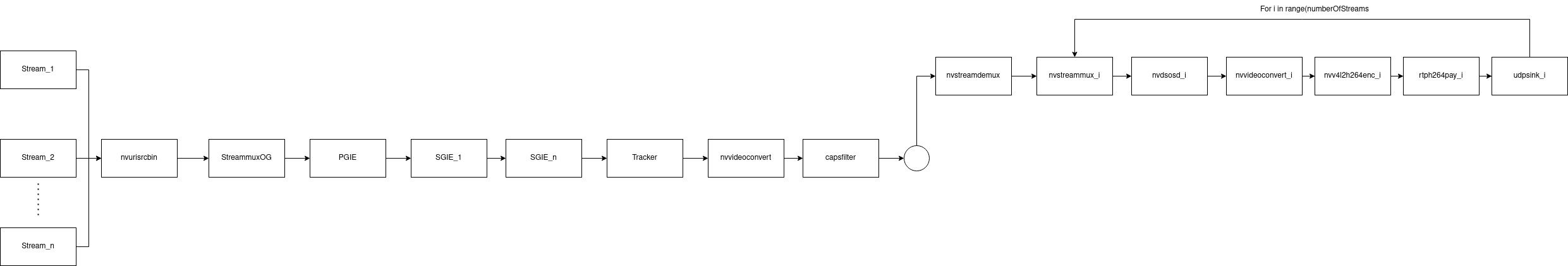

Here is something else that I have noted:
Here is my current pipeline structure:
    nvstreamdemux = Gst.ElementFactory.make('nvstreamdemux', 'demux')
    pipeline.add(nvstreamdemux)
    queue.link(nvstreamdemux)
    queue = make_queue()
    pipeline.add(queue)

Here is the structure of the entire pipeline:

I tested this script and it works well. It seems like the streammux element in my pipeline is the problem (The streammux element that is created dynamically based on the number of streams that is going to be processed). I adjusted my pipeline and removed the streammux element that are created dynamically and then the streams are able to be processed. The problem is however that my probes needs that streammux elements to do some of the processing. So I need to have those streammux elements there. I am unsure why those streammux elements causes problems tho…
No worries, somehow I got it working. Not sure what I changed but I am able to access the streams that are sent. Thank you very much for the assistance.
