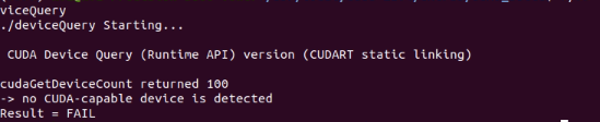

After that, I type ‘nvidia-smi’ to check the installation result and the product name space show ERR! and Persistence-M show Off as attached image
I have checked the deviceQuery and the follow error be shown as below:

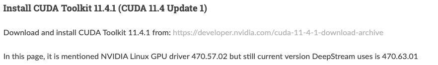

- If I upgrade my driver version to 5xx, the problem can be solve. However, I want to run Deepstream 6.0 on RTX A5000 if I use higher driver version I cannot install Deepstream 6.0 on it and as I checked the nvidia driver 470.63.02 also support RTX A5000 seri from download driver link
- I hope you can help me to solve the problem while still use nvidia driver 470.63.02
