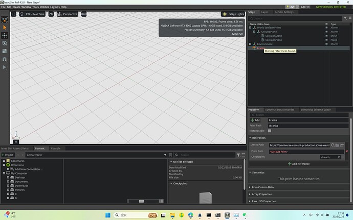

  Program not responding
Detailed Description
When I added the robot to the scene by going to the top menu bar and clicking Create > Robot > Franka Emika Panda Arm, the program stuck and then didn’t respond,what is the reason for this?
After many attempts, it still works, but creating cube and so on is no problem.
it says could not open asset @https://omniverse-content-production.s3-us-west-2.amazonaws.com/Assets/Isaac/4.5/Isaac/Robots/Franka/franka.usd,but i can open this url with my browser
Is this issue still occurring? If so, could you upload a complete log?
Have you downloaded the assets? Download Isaac Sim — Isaac Sim Documentation
