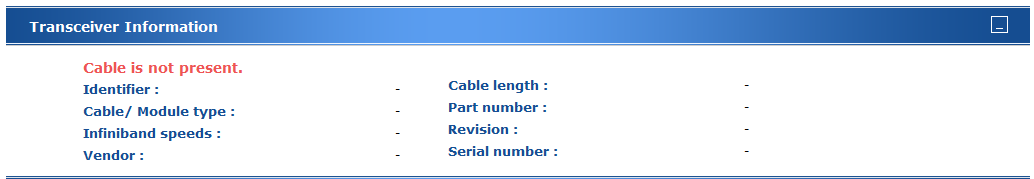

Q4. Cable information display problems.
I didn’t add a Fabric Inspecer License to 2 of SX6036G yet.
Whenever I connect new FDR copper or Active Optical cable to blank port, it show a message like below.
But long time later it show a cable information like below.
Main problem is FDR Active Optical cable information display!
If I reboot SX6036G switch then it show a cable information immediately
How can I resolve problem?
Is it Fabric Inspecter mandatory?
