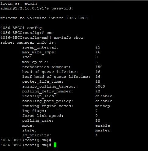

I want build a IPoIB VLAN virtual network via VST.
I’m also made a partition and each vSwitch setting was completed.
But just only VLAN 0, 21 works fine.
vSphere 4.x was greate works!
But vSphere 5.1 U1 wasn’t…
Do you have any solutions?

Below is result command that sm-info show

I’m so sorry for my late reply.
That’s a vSwitch’s VLAN ID for nested virtualization test environment.
I prefer to test all of VMware and Microsoft virtuaization technologies.

Hi inbusiness,
The way of VLAN configuration for IPoIB on vSphere 4.x/5.x didn’t change.
I suspect that you may have the wrong configuration on 5.x.
Can you please provide more information.
Subnet Manager PKEY configuration file
vmnic configuration (esxcfg-vswitch -l on ESX, etc…)

that’s odd,
can you try to set the full membership bit (MSB #16) in the pkey value for all the entries.
For example, instead of:
Partition10=0x10, use:
Partition10=0x8010

You are correct!
I’m test 0x80e7.
~ # grep -v “0000” /proc/infiniband/mlx4_0/ports/1/pkeys/*
/proc/infiniband/mlx4_0/ports/1/pkeys/0:0xffff
/proc/infiniband/mlx4_0/ports/1/pkeys/1:0x8001
/proc/infiniband/mlx4_0/ports/1/pkeys/2:0x8002
/proc/infiniband/mlx4_0/ports/1/pkeys/3:0x8003
/proc/infiniband/mlx4_0/ports/1/pkeys/4:0x8004
/proc/infiniband/mlx4_0/ports/1/pkeys/5:0x8005
/proc/infiniband/mlx4_0/ports/1/pkeys/6:0x8006
/proc/infiniband/mlx4_0/ports/1/pkeys/7:0x8007
/proc/infiniband/mlx4_0/ports/1/pkeys/8:0x8040
/proc/infiniband/mlx4_0/ports/1/pkeys/9:0x80e7
9 means partition order by created in partitions.conf.
1 means HCA port number.
0x80e7 means real partition number.
This case VLAN ID 9 wasn’t worked, but 231 was working correctly…
(e7 is hexadecimal number of 231)
Default partition number is 0x7ffff.
Therefore user partition number starts with 0x8.
Thank you for your help.
