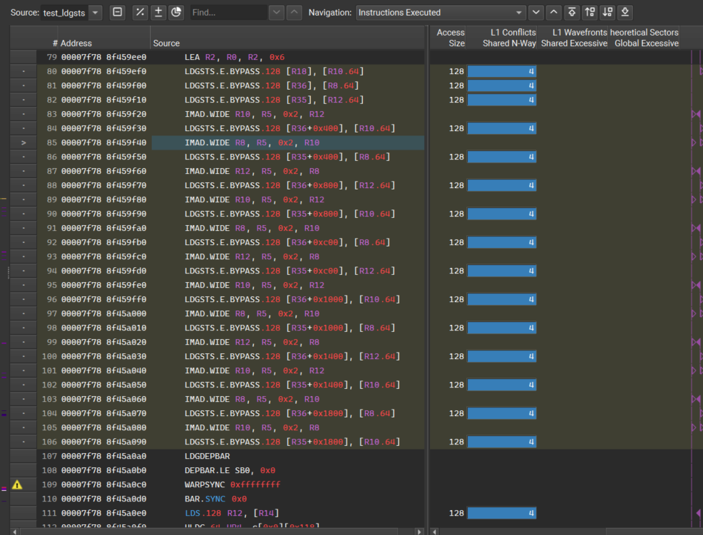

Hello, I have some questions about the following two kernels. Because I can’t explain some metrics correctly according to my understanding.
Environment
A100-PCIe-40GB
CUDA 11.8
Descriptions
Both of the kernels load matrix of size 1024x1024 half type matrix (row-major) from global memory to another part of global memory.
Kernel 1: using LDGSTS instruction to load data from global memory to shared memory. The shared memory size is 64x(64 + 8) in half type, 64x64 is the real memory size to contain the matrix tile, but a pad 8 half elements to the end of each tile row to avoid bank conflict for the following ldmatrix instructions(not included in the demo kernel).

Kernel 2: using LDGSTS instruction, but the shared memory is 64x64. I use the swizzle format to avoid bank conflict for the following ldmatrix instructions.

Nsight compute reports
metrics Kernel1 Kernel2
SMEM
Instructions 4096 4096
wavefronts 16384 16384
bank conflicts 0 0
L1/TEX Cache(Global Load to Shared Store Bypass)
wavefronts 8192 4096
sectors 98304 65536
Kernel 1:
Kernel 2:
Questions
  1. What is the relationship between “L1 Conflicts Shared N-way” with bank conflicts? According to Nsight Compute documents, the wavefront means the units that can be processed in parallel. If an instruction makes every thread access 128bit consecutive memory. Then every 8 threads will access 128byte consecutive memory, and there is no bank conflict, and will cause 4 cycles(or wavefronts?) to execute this instruction. So the L1 conflicts shared N-way is wavefronts/instruction = 4. But in Kernel 1, the L1 conflicts shared N-way is an average of 10, which means it takes 10 wavefronts to execute the instruction, and it still has no bank conflict, why?
  2. Why are the “L1 wavefronts shared excessive” and “L2 Theoretical Sectors Global Excessive” both not zero in Kernel 1? The access pattern in Kernel 1 is every 8 threads loads 128-byte data from global memory to shared memory, while in shared memory data is not consecutive stored across the subwarp. The L1/L2 cache line is 128 bytes, so I can’t understand the excessive.

Definitely. But “sectors excessive” can devastatingly affect the performance, so I make some test cases and want to find out what causes the performance degradation. At the same time, I am not very certain about the profiling result. So I post the questions in this forum first. I can also post my questions in the “Nsight compute” forum.
