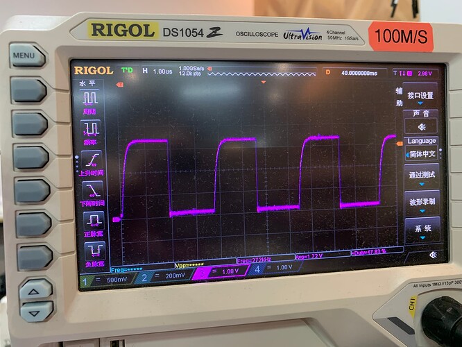

I am testing the level flip of GPIO in gpio app tak, the current maximum speed is 270Khz. This can’t meet my needs, I need about 1Mhz toggle frequency to simulate some LED(rgb) driving signal. I noticed that the maximum frequency of the R5 processor is about 200Mhz, want to know what is the maximum flipping speed of the GPIO of the R5 processor?
In other words, how to realize LED driving on orin nano? I tried PWM, but currently I have no way to realize a single variable duty cycle pwm pulse output on orin nano. It is used to simulate the output of 0 code and 1 code, that is, only one cycle waveform is output at a time, similar to the driving method of a stepping motor.
Though I’ve not tested, but your test result should be reasonable. If GPIO is toggled by software (SPE firmware), the max frequency should be unlikely to reach so high, like 1MHz.
