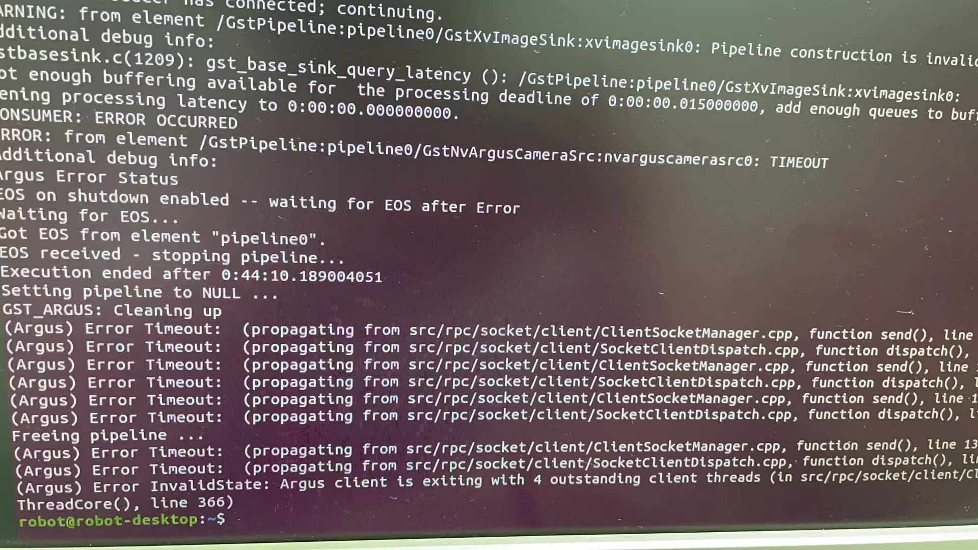

jetpack5.1.1
bsp3531
接一个摄像头能跑不到60分钟,接4个摄像头能跑不到20分钟,都是这个状态,请问怎么解决。

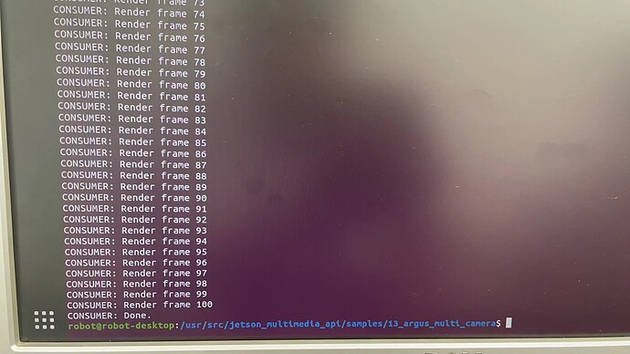

Could you try argus_camera of the MMAPI sample code to clarify it.
Hello, can you provide this example? Here, I have never used it like this before
Get the source by below command. And follow the README to build it.
sudo apt list -a nvidia-l4t-jetson-multimedia-api
sudo apt install nvidia-l4t-jetson-multimedia-api=35.3.1-xxxxx
- cd /usr/src/jetson_multimedia_api/samples/unittest_samples/camera_unit_sample $ make
要运行
- 进入:
$ ./camera_sample [OPTIONS]
捕获的预览流可以通过 HDMI 显示。
例
$ ./camera_sample -r 1920 1080 -fps 30 1
我拿这个打开了相机但是他不能长时间运行,我想长时间运行他
Run the argus_camera sample.

他还是运行几秒就推出了我想一直让他输出图像跑一天甚至更长的时间,谢谢
You didn’t run the argus_camera.
The source should be this /usr/src/jetson_multimedia_api/argus/apps/camera/ui/
Follow the README.txt the than you should be able run argus_camera any where.
