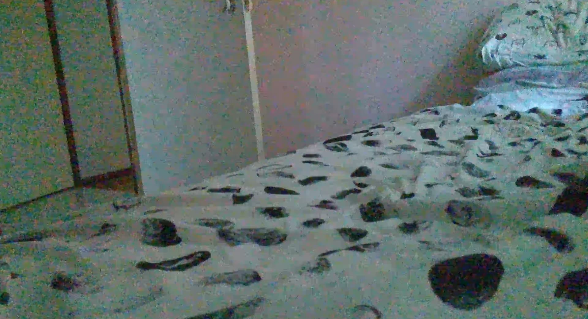

I am using my Jetson to constantly record 30 minute segments of video onto a hard drive. I’ve noticed that the file size seems to be much larger when recording during the evening (in lowlight situations) compared to when recording during daylight.
For example, a 30 minute recording taken during the day is 700MB. A 30 minute recording taken at lowlight is ~5GB
I’ve looked into the files to see what was happening, and I’ve found the issue. Here is a screenshot from each video file:
As you can see, during low light situations, there is some artifacting going on that makes compression much harder to do, causing the file size to be much larger.

The artifacting also happens when I stream in this manner:
gst-launch-1.0 v4l2src device=/dev/video2 ! 'video/x-raw, width=2560, height=1440' ! nvvidconv ! omxvp8enc ! rtpvp8pay ! udpsink host=192.168.1.111 port=5000 sync=false async=false
Anyone have any idea how to remove this low light effect so that my file sizes aren’t so huge at night?

In low light the scene has more noise which triggers higher bitrate in encoding. Encoding rate is more stable while the scene is clear.

I don’t think it is a h265 compression issue though - when I simply view the video with the following pipeline:
gst-launch-1.0 nvarguscamerasrc ! 'video/x-raw(memory:NVMM), width=3280, height=2464, format=NV12, framerate=(fraction)21/1' ! nvvidconv ! xvimagesink
There is still come level of confetti/artifacting, here is a gif of a screen recording that I took:
Is this just something that is always going to happen because of how the IMX219 works?

Generally we see more noise in low-light condition. It looks to be the behavior of the sensor(imx219?).
For further improvement, you may consider to check and try other Bayer sensors from our partners. Please check
