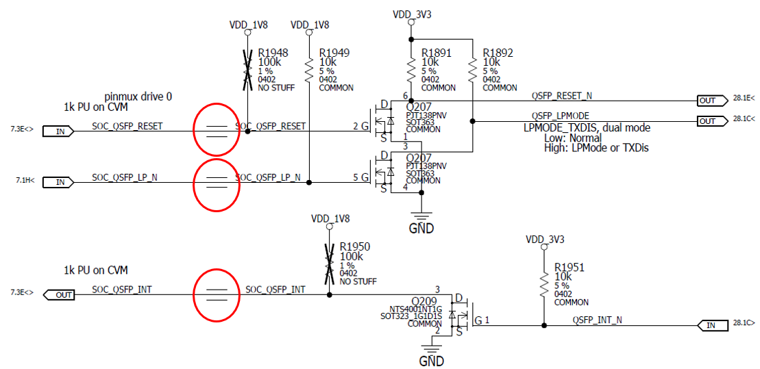

Regarding Symbol Notation on Circuit Diagrams for the Jetson Thor Devkit
In the circuit diagram provided for the Jetson Thor Devkit, there is a notation circled in red in the figure below. What does this mean?
Best Regards,
UNA
Those are net-tie / net-short markers.
They mean: “intentionally connect these net segments here.” Electrically, you can read them as a continuous wire.
