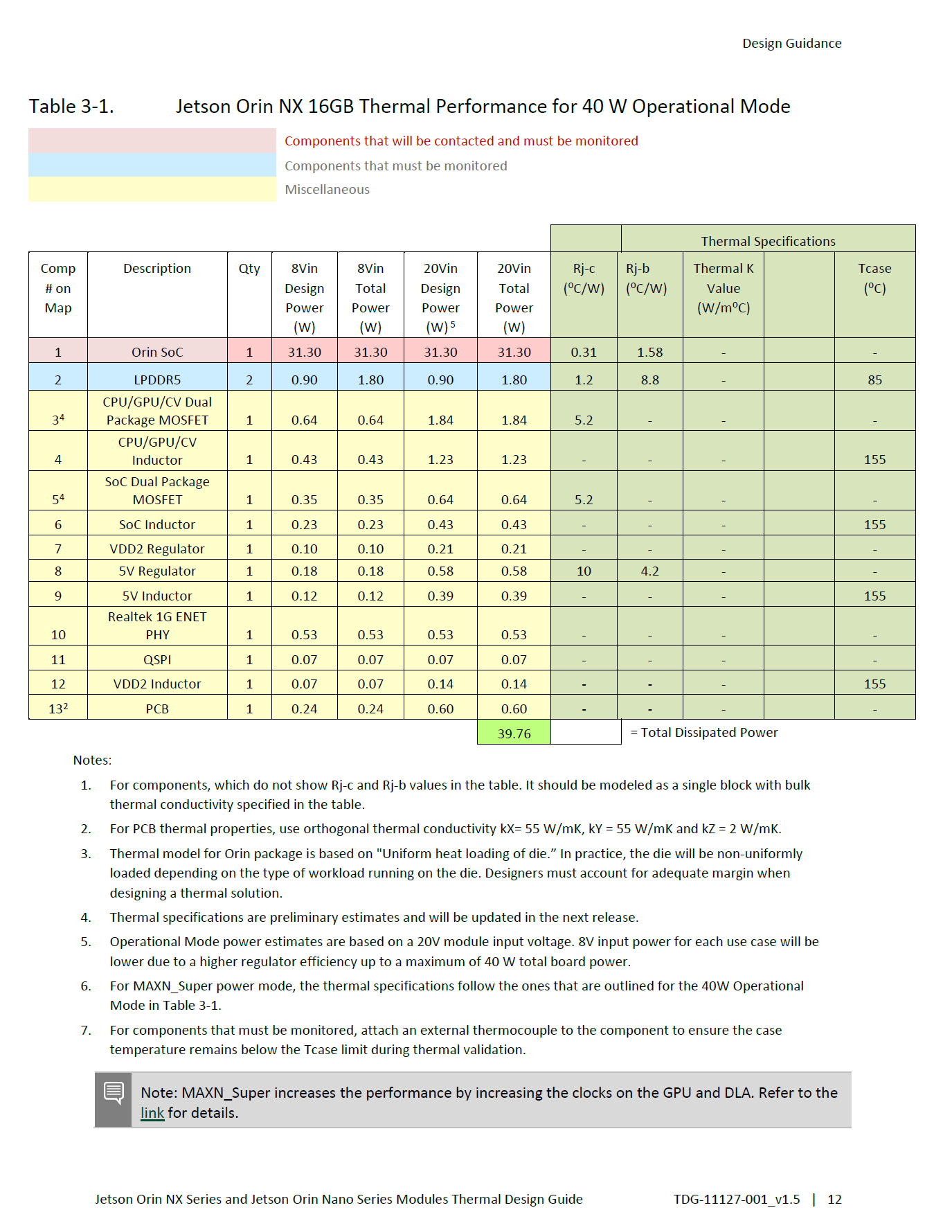

We are using JETSON ORIN NANO in our custom Design. We are looking for the ANSYS ICEPACK File for Thermal Simulation Request for your kind support.
sgursal
3
ANSYS ICEPACK thermal model for Orin SoC is not provided. Please refer to Jetson Orin NX Series and Jetson Orin Nano Series Modules Thermal Design Guide https://developer.nvidia.com/downloads/jetson-orin-nx-orin-nano-series-thermal-design-guide
