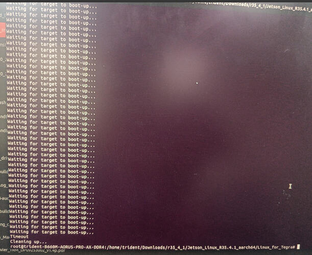

Further to this issue:
I tried performing restore operation on NVMe, but i am getting USB time out error.
pls find the log attached.
Reflash_Restore_Timeout_error_USB.txt (68.0 KB)
Kindly let us know the possibility for USB time out error.

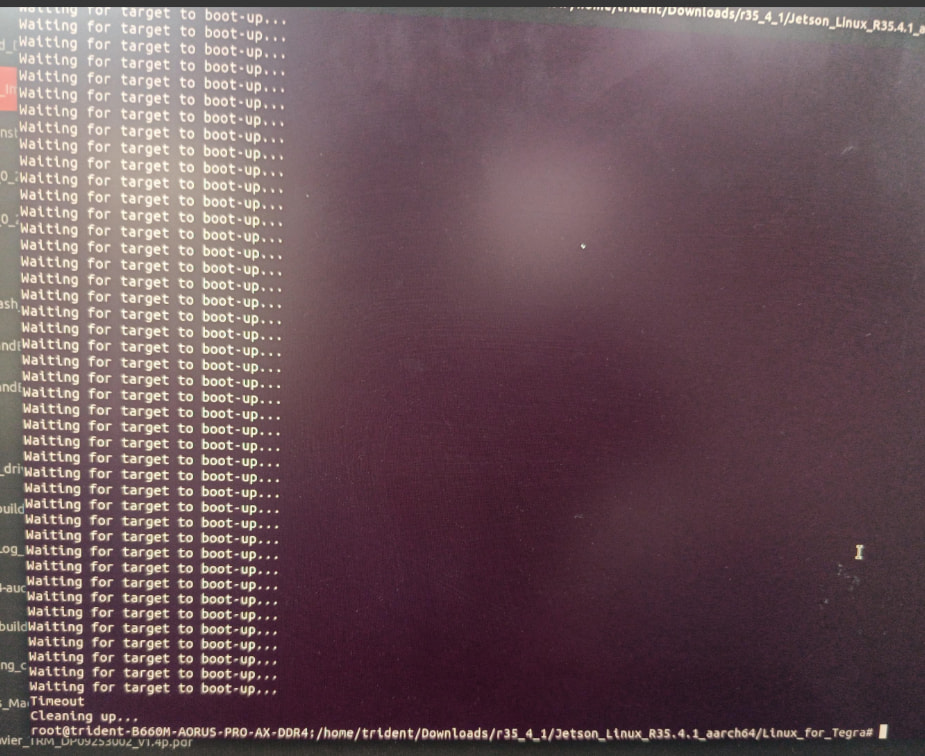

  1. I tried doing normal OS flash using the command below, but still the same USB time out error is coming. The log is attached fyi..
$ sudo ./tools/kernel_flash/l4t_initrd_flash.sh --external-device nvme0n1p1 -c ./tools/kernel_flash/flash_l4t_external.xml --showlogs --network usb0 jetson-agx-xavier-industrial internal
NVME_Flashing-USB-Timeout-Error-27-Nov.txt (206.5 KB)

Command I used to flash only the EXTERNAL NVMe is
sudo ./tools/kernel_flash/l4t_initrd_flash.sh --external-device nvme0n1p1 -c ./tools/kernel_flash/flash_l4t_external.xml --showlogs --network usb0 jetson-agx-xavier-industrial external
Few more observations:
  1. I observe that Backup / Restore and OS flashing works fine for internal eMMC ( mmcblk0) without time out errors.
  2. Full flash of NVMe which takes more than 1.45 hrs, fails with USB time out error ( I tried 2-3 times with diff USB ports still the same issue).
  3. I observe that during the waiting for unit to reboot time - the HDMI display turns ON and again OFF, later the USB times outs and quits.
Thanks,
Nagesh R

Only once i was able to flash successfully on NVMe( after changing the power socket and removing USB hub connection from Jetson), but later during pytorch installation process the nvidia kernel and other drivers got removed and unit was not booting anymore, so i want to reflash again but now all the time, USB time out error is coming even for the same power socket and after removing USB hub also.
Please let us know possible root cause for such behaviour.
In the serial log, I observe NVM0 - Device not ready error.
@DavidDDD Do you think its NVMe related HW issue?
Solution:
after changing the NVMe to a different PCIe lane which has switch , flashing was successfull.
Probably the PCIe RST signal coming from the SOM was early on the PCIe line straight from the SOM where NVMe was residing.
