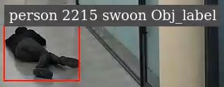

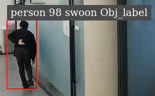

When setting the tracker to 0 and running the deepstream-test5-app, the YOLO model and fall detection secondary model correctly identify “falls” event when the subject goes down and return to ‘None’ state when the subject gets back up. However, when setting the tracker to 1 and running deepstream-test5-app, using Nvdeepsort or similar, there is an issue where “falls” are either not recognized at all or, in the case of a subject getting up after a fall, the system continues to maintain the fall state instead of transitioning back to normal.
Ultimately, I am curious if there is a way to disable the result correction performed by the tracker. Is there a method to turn off the result adjustment in the tracker?
tracker_off_none
tracker_off_fall
tracker_on_none
tracker_on_fall

Seems your “fall detection secondary model” is sensetive on the BBoxes. Can you check why “fall detection secondary model” fail? Is it possible to put your model before nvtracker?
We have already configured our system to activate the tracker after the secondary model (Resnet) operates. We believe that the tracker influences the results of the secondary model. In conclusion, we would like to know if there are options or elements that allow the tracker to impact the results of the secondary model and how to disable that.
Can you have a try with org_bbox_coords: NVIDIA DeepStream SDK API Reference: _NvDsComp_BboxInfo Struct Reference | NVIDIA Docs?
