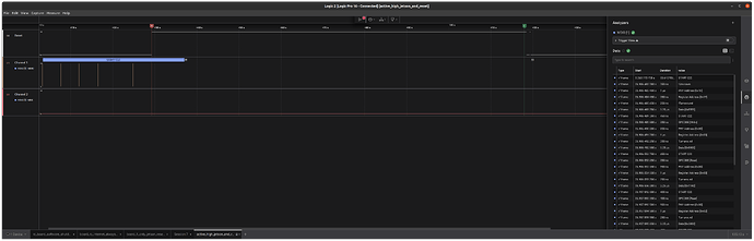

We also observed that G5 is not going low after the sequence if it is physically disconnected from the phy.
My best guess: In the absence of a “misconfigured” reset signal, the PHY starts, initialization with the phy works (70% of the time) and the jetson is happy keeping the signal on high.
When the reset is connected to the phy something about the signal makes the phy fail to respond correctly which makes the Jetson decide that it wants to keep it in reset forever.
This is based on the observation that in this case the Jetson tries (and fails) to exchange information with the PHY right before it’s pulled low.
This does not happen when the reset is physically disconnected though…
Just to clarify the diagram you shared previously.
From this one I saw reset is from low to high and then low. It means reset should be set to high active.
However, one problem here is the timestamp seems too long. Looks like it took about 90 sec ?

We thought we did that, but it turned out we had an overlay in ODMDATA, that overwrote the status with okay again. This is fixed now, but apart from some dmesg error logging related to 6800000 disappearing it did not change anything.
The interesting part of the reset sequence is just in the very end. If it’s high or low for the 90s before that is not relevant I think.
At the end of the reset sequence we can see some MDIO communication that’s trying to read the id from the PHY, which fails and just returns a bunch of F’s:
We could also find the offending line in the kernel Code (kernel-jammy-source/drivers/net/phy/phy_device.c) and confirmed it with a print statement. See the following code on the very bottom. It has WARNING@231000 prepended, so we can easily grep for these messages:

It handles the exact case we also see in the logic analyzer: Reading the phy ID returns mostly F’s.

Increasing nvidia,phy-rst-pdelay-msec increases the time the reset line stays high in the two high-pulses in the image above.

phy_reset_duration is nvidia,phy-rst-duration-usec which is how long this reset GPIO is set to 0 and then 1.
and phy_reset_post_delay is how long to wait for this reset pin toggle and then move to next steps.
I wonder we need PHY vendor to check what requirement is missing here too as our MAC driver is not able to read out phy id.
The configuration of the reset works and I have verified with print statements.

I still don’t understand, why the Ethernet works (80% of the time) if we disconnect the reset line between the phy and the Jetson. In that case it is apparently able to read the ID. Setting the phy_reset_post_delay to a whopping 30s does not help either.
I could also not found the place that sets the reset to 0 in nvethernet/ether_linux.c. None of the gpio_set_value(pdata->phy_reset, 0) seem to be executed based on some printk’s (same for gpio_set_value(pdata->phy_reset, OSI_DISABLE))
Something that is also weird is that the reset you mentioned should just go to low and then back to high. The sequence we are seeing seems to do this twice. The reset sequence you posted is however executed only once according to some prints I added.
