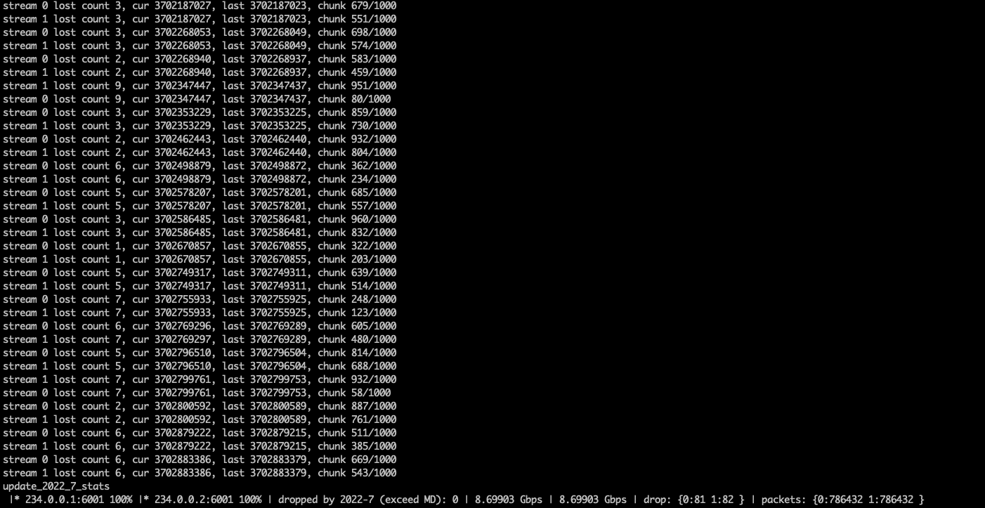

sudo numactl --membind=1 ./__cmake/media_receiver/media_receiver --sdp-file sdp_2022-7_2160p50fps.txt -i 192.168.10.20,192.168.20.20 -a 50 -b 51 -r 26
bose media_receiver print lots of Drop packets error message:
ERROR !!! Drop Packets - count: 85899345920
I add sequence number lost count check in class in_2022_7_stream_sw::process_rmax_in_completions
if (0 == get_rtp_param(ptr, sequence_number, rtp_timestamp, m_bit, f_bit)) {
if (m_last_seq[s_index] != -1) {
int64_t last_seq = m_last_seq[s_index] + 1;
uint64_t lost_count = ((uint64_t)sequence_number + 0x100000000 - last_seq) & 0xFFFFFFFF;
if (lost_count) {
printf(“stream %d lost count %lu, cur %u, last %ld, chunk %lu/%lu\n”, s_index, lost_count, sequence_number, m_last_seq[s_index], stride_index, chunk_size);
m_7_statistic.lost_counts[s_index] += lost_count;
and add m_7_statistic.lost_counts to stats print.
I found that total of lost count is about 100 during every stats print(1 second)
