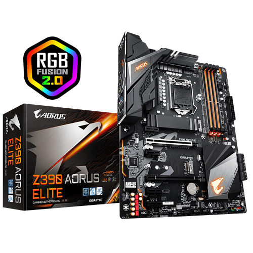

You need to read the manuals.
http://us.download.nvidia.com/XFree86/Linux-x86_64/460.39/README/index.html
Theres so much wrong with how youve configured the system. I havent got time to get into it
You are far from close.
Ive read this quickly.
Your missing nvidia libraries?
And only the nVidia audio driver is loading your MBoard ,
AMD is on and fighting with and the Nouveau and FBuffer and Vesa Driver.
Turn secureboot off forever.
turn csm of forevr
( As per the latest nVidia instruction )
Turn AMD GPU driver off in BIOS.
Turn AMD Graphics SLice Off in BIOS
So youve got no blacklisting or modeseting.
So blacklist everything and modeset everything.
The Cuda driver is installed and running. Why?
Uninstall it for now.
Your DMA buffers arent set to 64bit in bios.
Set above 4G decoding in bios to 64bit. ENABLED
Disable IOAPIC 24-119 Entries in BIOS
Legacy USB Support disabled
XHCI Hand-off disabled
PCIE Bifurcation Support PCIE x16, : This has to be set to everything on pcie 1 slot
eIGFX On board graphics off
ePCIe 1 Slot Sets the graphics card on the PCIEX16 slot as the first display. (Default)
ePCIe 2 Slot not used
ezraid off. I think youve got the pci e slot running as a raid
VGA Support? Im not sure about this Id leave it to legacy first until you get up and running.
PS2 Devices Support ?? Not sure I would disable this. This is connected to echi / iommu /xchi
theres been changes in the kernel with xinput…libev…so on. disable this.
Boot Option Priorities uefi / secureboot /csm off.
Profile DDR Voltage
When using a non-XMPmemorymodule or ExtremeMemory Profile (X.M.P.) is set to Disabled
AVX Offset disable if you can
Graphics Slice Ratio off these are for AMD Carsds only and Radeon at that.
Graphics UnSlice Ratio off
Intel(R) Turbo Boost Technology turn off for now
Max Link Speed set to auto or gen 3
Internal Graphics set to DISBABLED
Set both DVMT options to minimum even though Internal Graphics is disabled
RC6(Render Standby) SET TO DISABLED ANY WAY
Platform Power Management [ DISABLE ]
Id bet there a WRONG config issue with M.2 stogare RAID support aswell.
I would do a clean install once youve fixed settings.
secureboot off. lm-sensors, fw-update, PCI-ID utils need to be run.
PAT CPU Support on.
Blacklist and modeset everything.
Chapter 38. Addressing Capabilities? nVidia manual.
Whys your card reporting 47bits?
Driver fails to initialize when MSI interrupts are enabled,
Not the issue but be aware of it.
Chapter 19. Configuring Flipping and UBB: maybe enable
outta time.
Good luck
