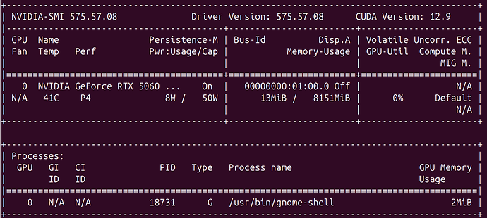

I have a Lenovo Legion Pro 5 with an RTX5060 running on Ubuntu 25.04 with nvidia open driver version 575.57.08. Both when idle, and running a heavy workload such as training a machine learning model, nvidia-smi shows that the power limit is 50W while it should be 115W.
When training a machine learning model, GPU utilization reaches 100%, power reaches 50W out of 50W while the temperature of the GPU stays at 55-60 degrees (far from maximal allowed temperature AFAIK). When running nvidia-smi -q -d clock, it seems that the GPU clock speed is being throttled. Given the power and the temperature for such a workload, it seems that the maximal performance of the GPU is not being utilized.
I tried setting power limit using nvidia-smi -pl and it claims it’s not supported for this GPU.

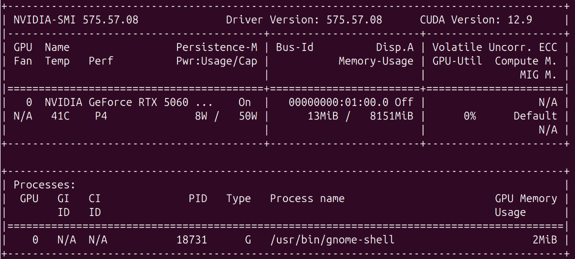

nvidia-smi when idle:

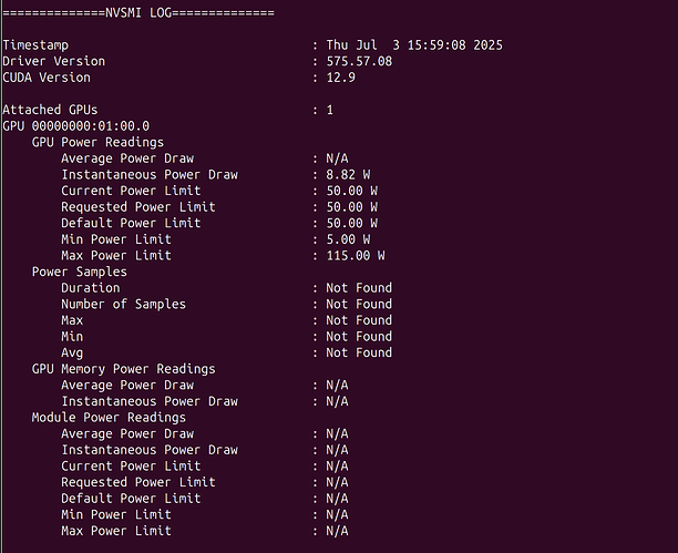

This is the output of nvidia-smi -q -d power:
It’s clearly stated that the max power limit is 115W. Also, in Lenovo’s official website, it clearly states for this specific model, that the GPU’s TGP is 115W: https://psref.lenovo.com/Detail/Legion_Pro_5_16IRX10?M=83NN002GIV

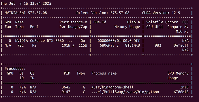

Alright, after some troubleshooting, I found out that running
sudo systemctl enable nvidia-powerd.service
And resetting, solved the problem for me, as can be seen in the below nvidia-smi, undear heavy workload (training a deep learning model)
Also, specifically for lenovo legion pro 5 gen 10 (my model), pressing fn+Q switches between 3 - different power profiles: one which limits the power to 40-50W one that limits to 80-90W and one that limits to 115W. Before the above systemctl command, the fn+Q shortcut had no effect.
