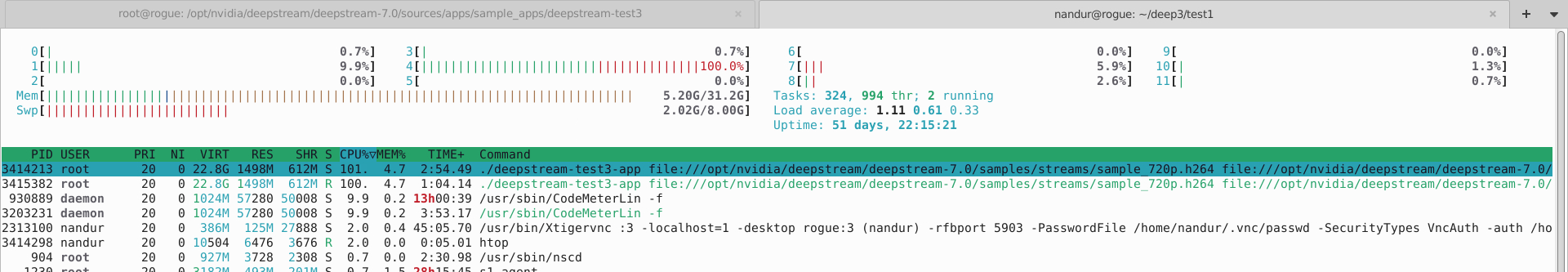

The below image shows gpu usage of python bindings with yolov9e engine

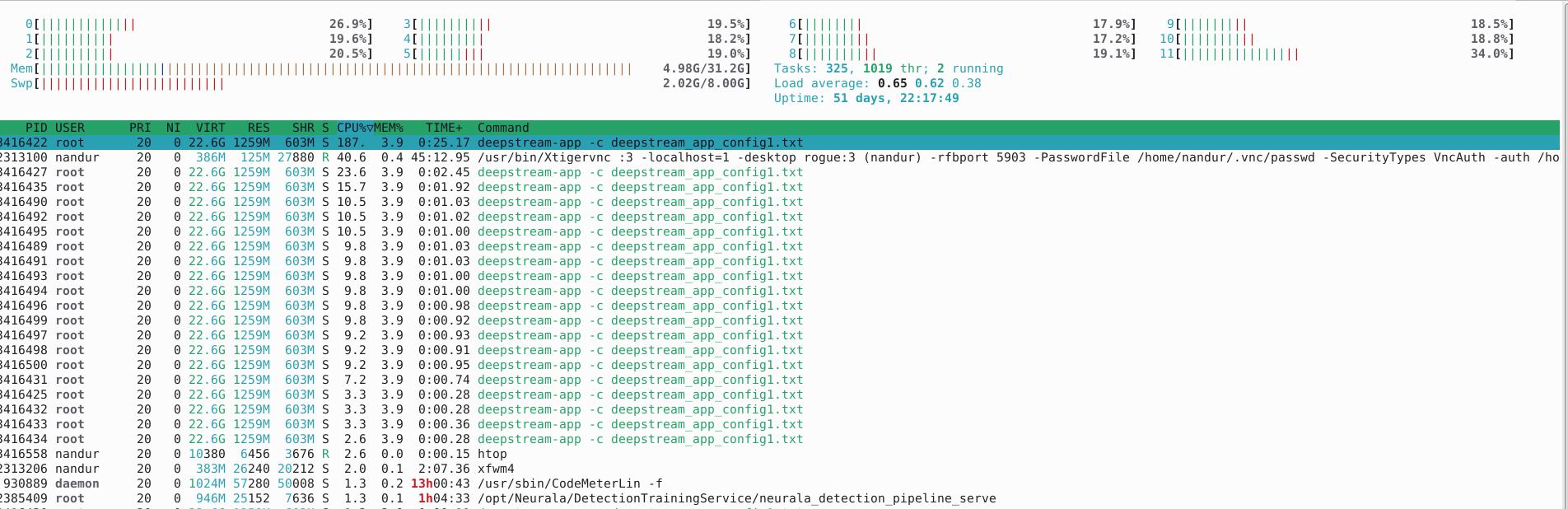

The below image shows gpu usage of binary option(Ultralytics YOLO11 on NVIDIA Jetson using DeepStream SDK and TensorRT) with yolov9e engine
Why are there multiple python instances? This seems to result in different video memory usage.(742M vs 2894M)

1.Why are there multiple python instances? Sorry don’t know about that
Also i ran cpp sample application with yolov9e - deepstream-test3(multistream 6 video input) and FPS observed as same as using python bindings about 5-7 FPS.
Here below GPU usage of deepstream-test3(cpp) with multistream(6)
Here below GPU usage of binary(deepstream-app) with multistream(6) and FPS observed 23-24

1.For deepstream-app, just add multiple sources in the configuration file and start one process. There is no need to start multiple instances, which uses too much CPU/GPU.
2. Use fakesink to make the pipeline run as fast as possible to avoid the impact of clock synchronization
